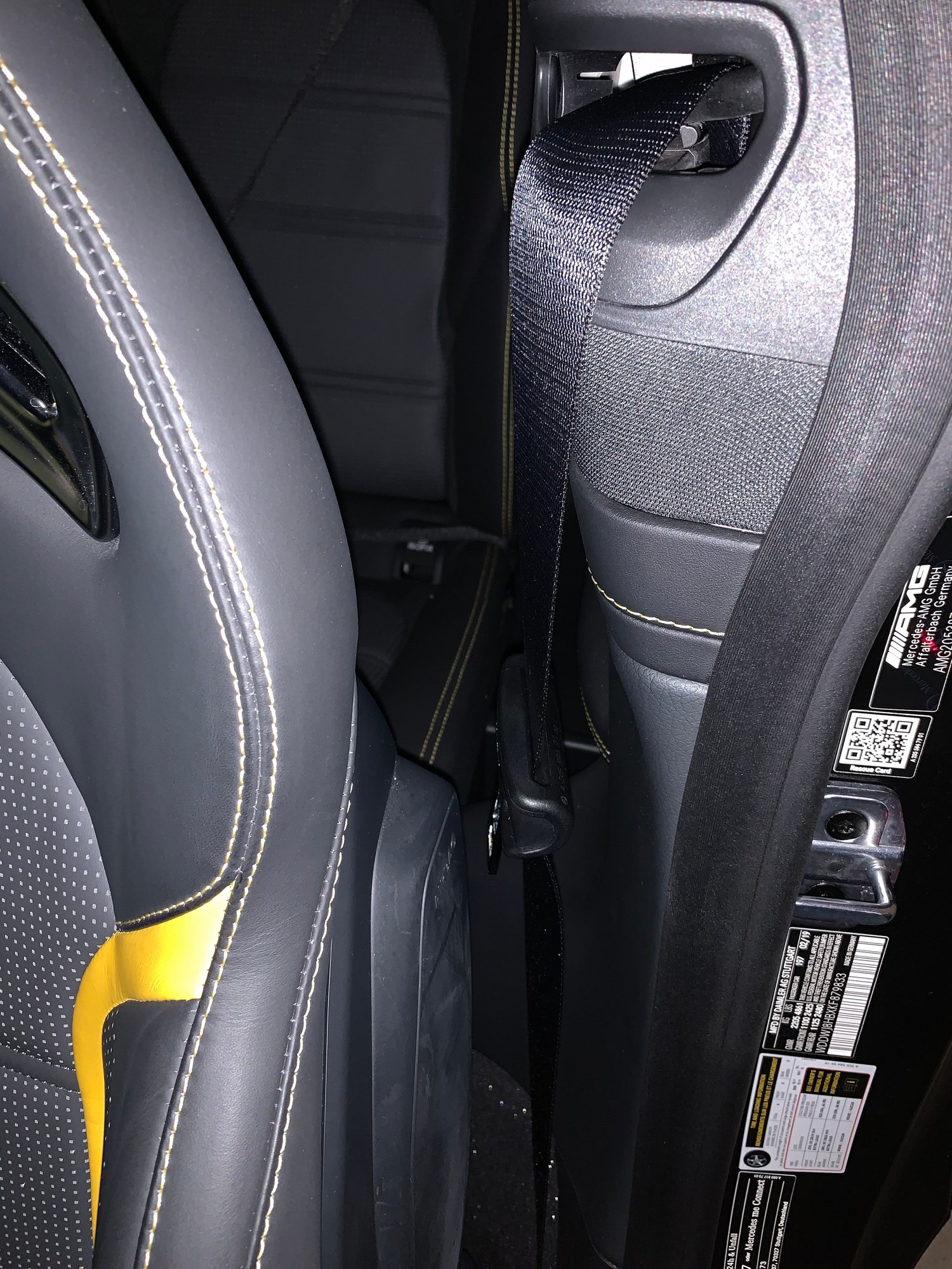

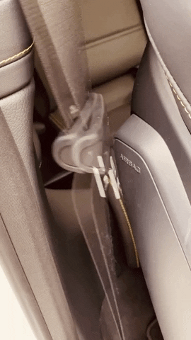

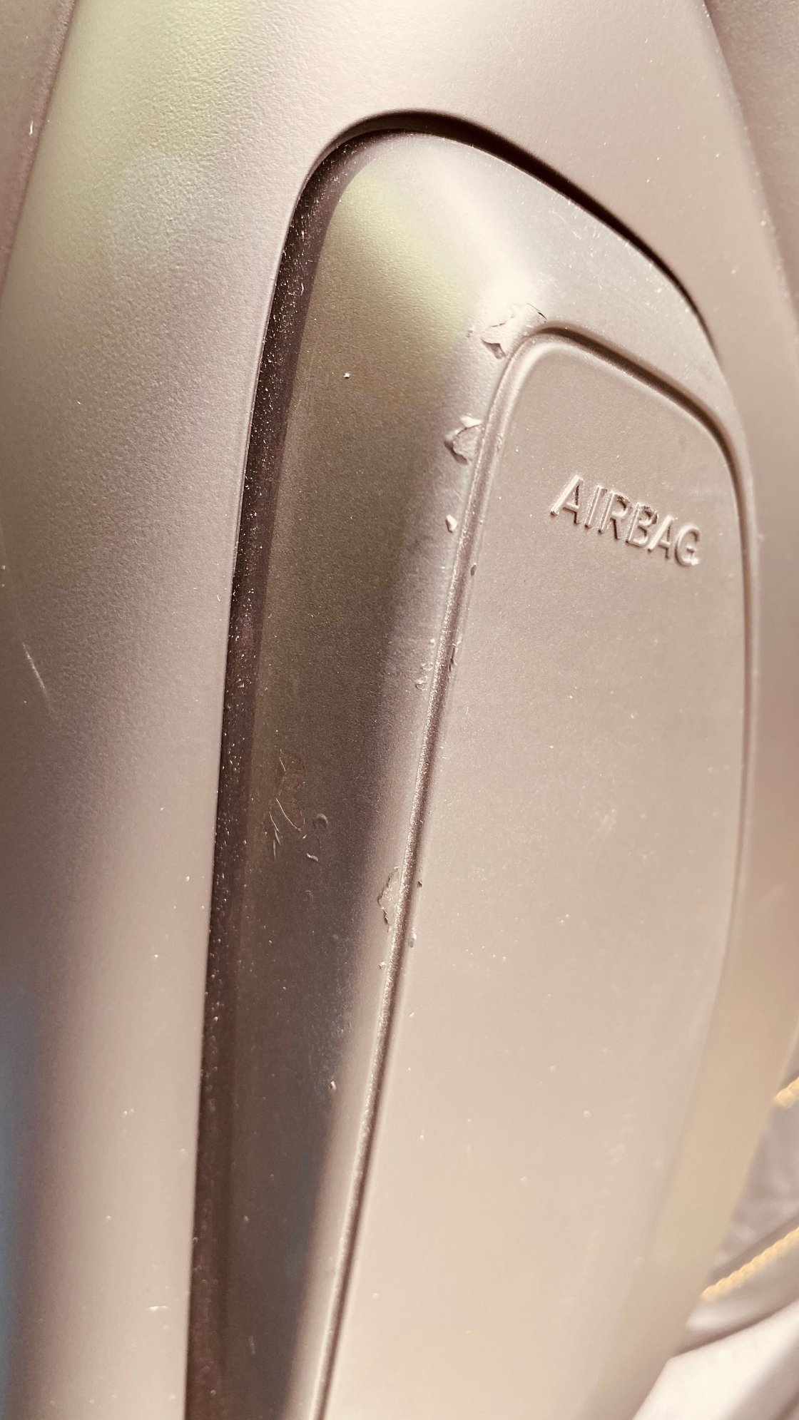

Forgive me if this has already mentioned here but I wanted to see if you guys have the same issue and if there's solution...
On my performance seats when there's no front passenger, the seatbelt keeps knocking on the seat side-airbag plastic when driving (coming to a stop and accelerating, hitting road bumps, and turns) which it:
1. makes knocking noise and becomes annoying after a while.
2. scrapes the airbag plastic surface.
