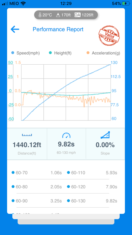

There is something very weird here. I can t believe that with a tune a car gets slower from 60-130. It doesn’t make any sense. Why tune it then?
If they say that it will be worst 0-60, that s something understandable. More wheel spin, we are talking of RWD cars. But 60-130??
This is my best time, in very leveled road, with 98 octanes ( Europe ).2019 facelift C63S sedan, stock, 19 wheels

I couldn’t get 0% grade but personally the “valid” run here of +3% incline genuinely felt very uphill towards the end to me, while the “invalid” -1% decline one felt darn near flat.
this is with Renntech HHT stock everything else.

Wow those are some solid 60-130s on stock and with HHT only. Mine is wayyyy off that.
Update: i did sparks and new filter. No real damage to sparks. One was a bit oily and more worn than rest but overall they were fine tbh. replaced air filters on intakes- they werent dirty but now theyre upgraded too. Didn't get a 60-130 time documented yet. The car doesn't actually feel much. faster than before.
My friend has a modded Z06 (500 RWHP) and when my car was stock he would pull a car length away from me from a rolling start up to like 200 km/h almost. We did a run yesterday and from a launch we were neck and neck all the way basically (so yes the tune worked on low end...) but on higher speeds I got left behind same as I did before. Same comparison with my friends bike he pulls one car length away too and nothing much. changed there from when car was stock to now its tuned.

thanks for the link. ill start with 8 gallons 94 octane and 1.25 gallons 110 octane. see how car times on that to start.
my 60-130 should still be considerably quicker than 10 seconds plus tho. even if stock turbos are slowing me down.

makes sense man. i haven't sent the tune back yet. i'm going to test more 0-60 and 60-130 and 1.4 miles to get a really good set of times so i know where the car is sitting right now.
take a look at the spark plug pic and see what you think? i didn't think it was major.
i dont have a data logger. renntech didn't really help when i asked what i can use to send info back. so if anyone can link me to something to go and buy ill get it and log some stuff. like i mentioned before never done it before so its new to me. my Dragy also broke yesterday so i couldnt get more times. dam thing doesn't charge. its basically brand new too!

plugs look fine (i.e. no oil or catastrophic
issue). They can look just fine and need replacing on a tuned M177 though.
stinks about your dragy. Maybe contact them for support if it’s new. Mine is about a year old and only holds 80% charge.
remeber your HHT has one easy button to switch back to stock.
get your gas quality/octane settled. Get your dragy working. Get a cheap OBD2 app or plug in unit to log (there are many discussed around here). You’ve already got nice new plugs.
Then put your car back to stock with the HHT. Record three runs and document the logs and dragy times. Then go reload the tune with the HHT and do the same.
Then, if anything seems odd with the tuned dragy times, you can look at your logs for timing being pulled or whatever.

UPDATE:
I tested MS103 race fuel. Made a blend to bring my car to a true 94 octane (considering my 94 octane up here in Canada is more like 89 octane).
Results:
0-60 no improvement. still sitting from 4.1-4.3 seconds.
1/4 mile no improvement. still above 12 seconds mostly 12.3.
I did notice 4th gear is now a huge power surge. where I'll be honest it's almost too scary? I didn't feel that before.
1st gear- still slips and struggles for traction (running 295's remember on rear and i warmed them up with a burnout first too)
2nd gear- feels like it pulls hard and instant torque
3rd gear- feels a little sluggish dare i say it? now im comparing to 4th gear...
4th gear car pulls hard its liek boost comes in super strong and it flies.
When i raced my friends MT-09 bike he used to jump a car length or 2 ahead from 60kmh rolls. now we were alot closer he was maybe 1 car if that. When we went from a 100kmh roll it was almost dead even now when before he still pulled a car away.
I didn't get anything dyno'd tho. It doesn't seem like the issue is resolved. Yes race fuel helped but it was always going to improve a bit. doesn't seem like its enough.
Anymore advice on what I can get checked? Car was parked over winter... maybe battery? auxiliary battery malfunction comes up still but thats just for stop/start function so i don't think that causes any issues.
sparks are done, air filters new.
I would have a CEL if i had a boost leak, thought maybe downpipes were damaged somehow. Need advice please this car is frustrating me now! meant to go to Area 27 racetrack on june 14 but with it performing like this I don't even want to go

yeah definitely frustrating. i booked my car in for a dyno with data logger hooked up.
so we will flash the car back to stock. run it on dyno. then throw tune on. run again and see what shows up. only thing i can think of and cross my fingers that something comes up!!
I ran the car against the MT-09 bike again. its running better since the race fuel was added even though thats finished now and im back to just pump 94 (89 octane).
something has to be up with why 3rd gear doesnt feel so strong but 4th feels like twice the power.
