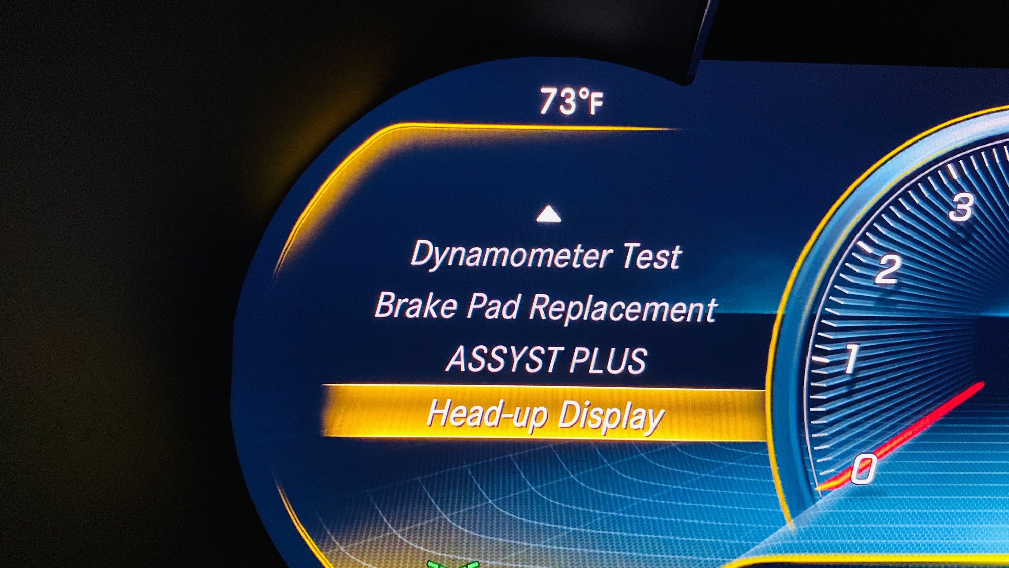

Hey guys,
I just received my Porterfield AP1669 R4-S to replace my rear brake pads and I understand that I'm supposed to retract the electronic parking brake within service/shop mode. I've been looking around to find instructions on how to get into that menu but I don't see anything for our model. Can someone shed some light here please. Thanks!!!!!!
Update:
I was able to follow the instructions in below video and get into service menu. Surprisingly, you'll find other useful menu's such as: Vehicle Data, Dynamometer Test, Brake Pad Replacement, Assyst Plus, and Head-Up Display Settings.
