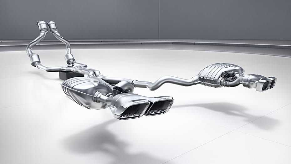

2020 AMG Performance exhaust is pretty much straight pipe with no resonator in between secondary cat and rear muffler.
If you use flap module such as ASR to keep exhaust flap to open full time, it will pretty much run as loud as it can get.
On yours, sound restriction is on downpipe with those 2 cats.
No aftermarket catbacks will make significant sound improvement vs. AMG Performance exhaust with ASR module activated.
