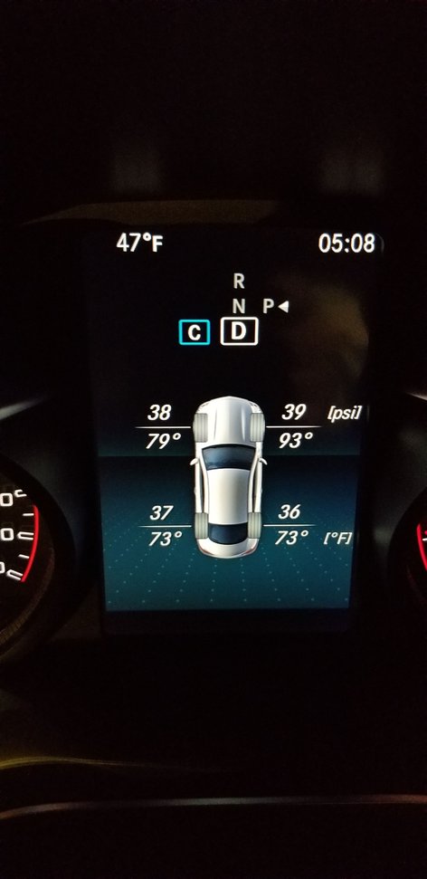

This past saturday with summer tires still on I took a mostly steady 2 hour drive around NYC area. The temp was a cold raw damp 43° F. Just before ending my drive I photo my tire temperature (summer tires). See photo.
I would suggest, if you have not already, to obtain these tires especially if it's a Daily Driver.
