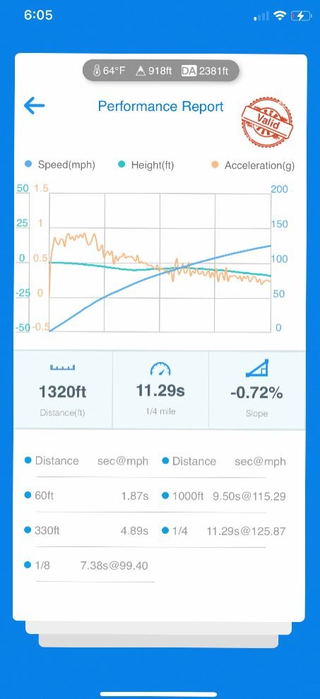

Get better tires - adding more power will only make you slower if you don’t have the grip from a dig. You need to do better than a 2.0+ 60 foot.
I’m running AMR Performance stage 2 93 octane tune with Modalworks intake and 200 cell catted downpipes. I have 305/35/18 Nitto NT555RII’s at about 28 psi in the rear.
DA was over 2000’ and run was done on the street. 11.29 @ 125.87. On a prepped sticky track and a nice burnout to heat up the DR’s, I’m confident I can break into the 10’s with stock turbos in nice weather.

Pretty Impressive numbers, especially on the street. I'd be super happy with that!

Do you have stock wheels? 305 is a really nice size I have 285 on stock AMG wheel. I’m really impressed with your time. I left out when I was reading old replies from 2015-16 people had upgraded turbos running the same time you currently have! Which is insane I wonder if tunes have gotten better because I don’t see any benefit from upgrading turbos if the times are almost identical to stock turbos
