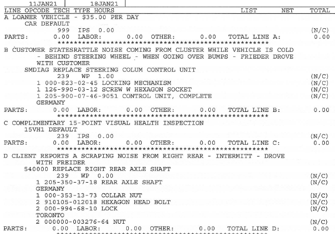

Got both the rattles fixed. Surprised needed to change one of the rear axles on a brand new car. On the plus side convinced them to change the differential oil under PPM.

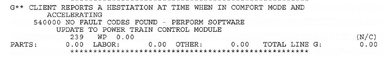

And there was new powertrain software as well:
