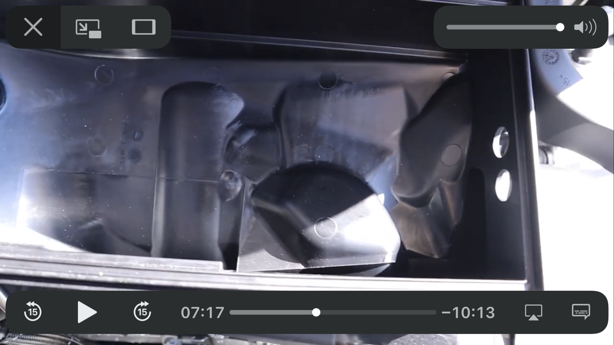

2021 C63s Engine/Cabin Air Filter Swap (OEM<K&N) DIY
If anyone was interested I have this DIY video on swapping out OEM air filters, wait till you see what I found damaged in my brand new c63s.....

I just watched the video. What are these 2 hole in the airbox for? I alway wanted to do that on my car. I had has great results with 2 hole in my Slk230 kompressor airbox. I can definitely feel the torque increase and better throttle response.
