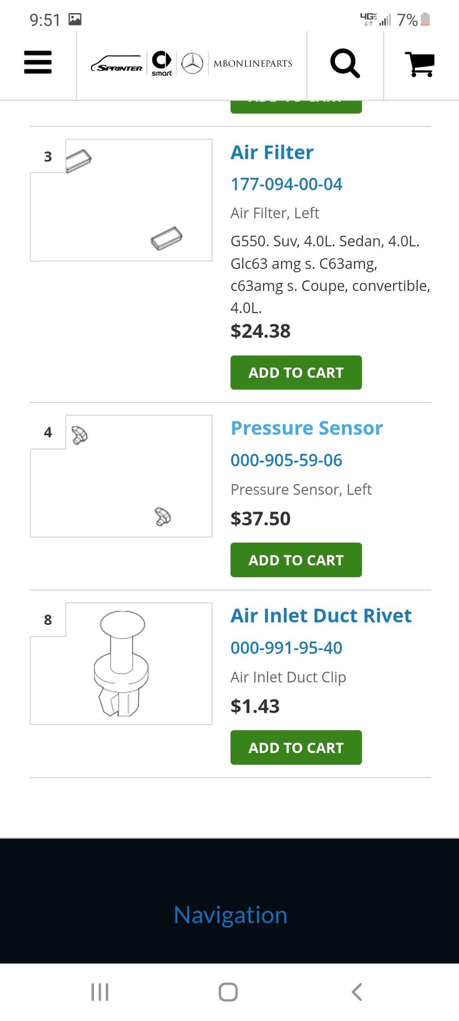

Ok im done with you guys. If you ever need to replace that part make sure you tell the dealer it's not a map sensor when he tries to order it for you.
You can't go off of what Mercedes calls parts. They call the turbo/intake inlet coupler "boot" they also call 17 other items "boot".
The part is made by bosch and is a map sensor. Bosch the maker of the part calls it a map sensor!
Call ZAC, Modal or black box and tell them they don't know what they are talking about or call almost anyone in the GLC 63 Club and tell them since their MAP Sensor isn't connected, their 10's 1/4 mile cars are not working correctly....
Tie up air sensors or mount them to the Heat shields if supplied.(these are redundant as they only measure how dirty the stock filters are)
