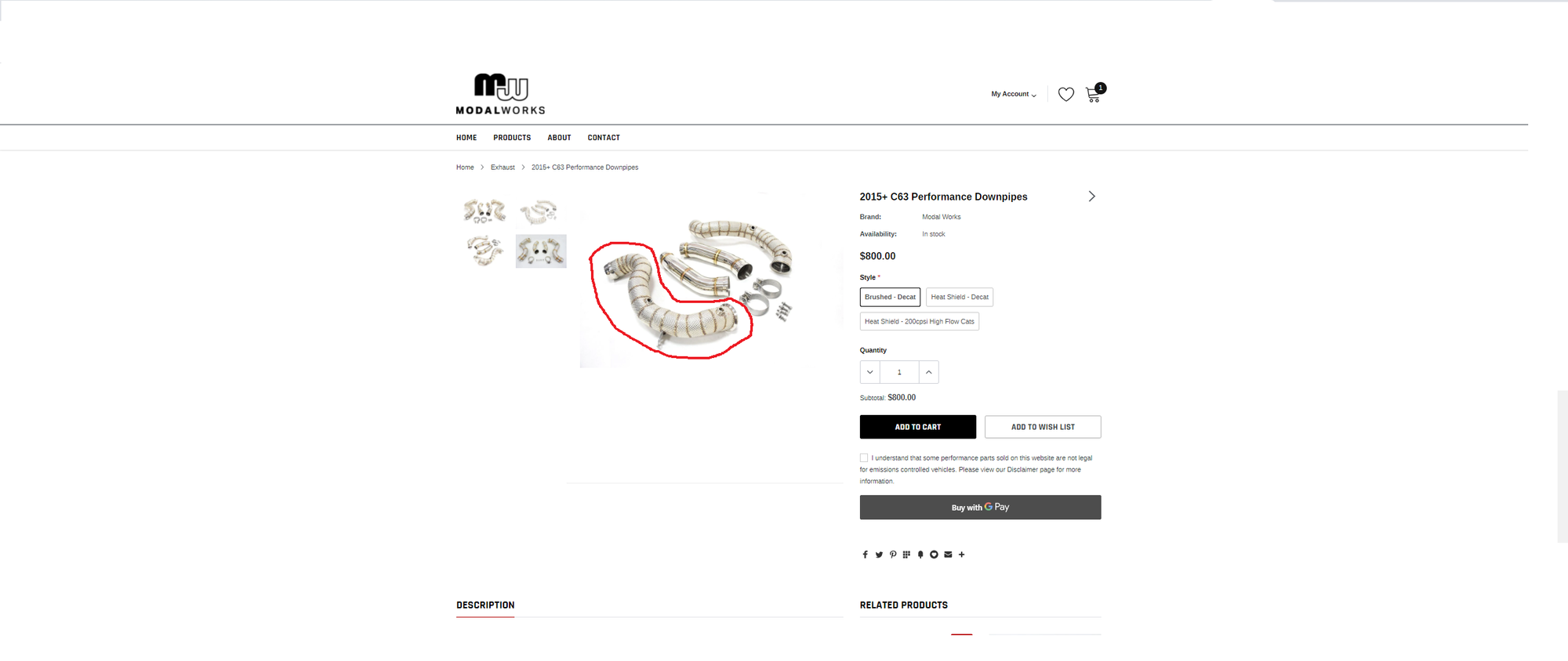

HI ModalWorks,
I've just found that from the ModalWorks website that you guys also with the size of 3.5"
Old May 29, 2021 | 11:51 AM
hao_song1128's Avatar
Joined: May 2021
Posts: 4
W205 C63S
Originally Posted by ModalWorks
All downpipes on these cars have their widest opening near the turbo, which is about 3.5”. Some vendors advertise their downpipes as 3.5” because of this initial section of tube before transitioning back to 3”.
We mention this on our website as well. Overall, 3” seems to be appropriate for nearly all power levels ranging from OEM to aftermarket turbos.
is this the initial section of tube ?
