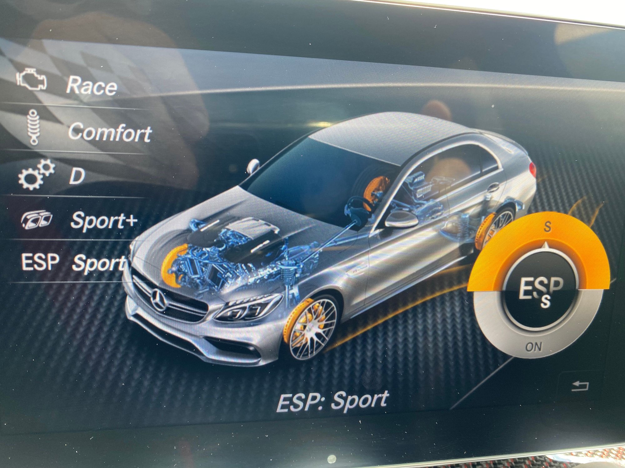

So I finally got around to trying this. I went into Vehicle Settings | ESP. It was on so I pushed the controller and it switched to Sport. If I hold the controller down for 3+ seconds nothing happens. Traction Control is still clearly interfering. Am I missing something obvious here?
This is on a 2015 PFL for reference.

Wrong place. That's your individual mode configuration, which only gives you the option between Sport or On. There's a physical button to the control the ESP.

Hmm, that's what I started with originally. Definitely held that for 3+ seconds and it shows the icon on the dash as being off but it's still cutting power when there's wheelspin or gets a little sideways.
Then something is not working properly or you didn't press it long enough. I think there should be a warning coming up, too, and yes it should say ESP OFF in the instrument cluster. Below picture is from my car with the digital instrument cluster, so yours will be a little different but it should clearly say ESP OFF. I had my car 90 degrees sideways in Race mode and ESP Sport and was doing 360s at the AMG Driving Academy with everything off, so if yours is cutting in when you are only going a little sideways then something isn't right.
