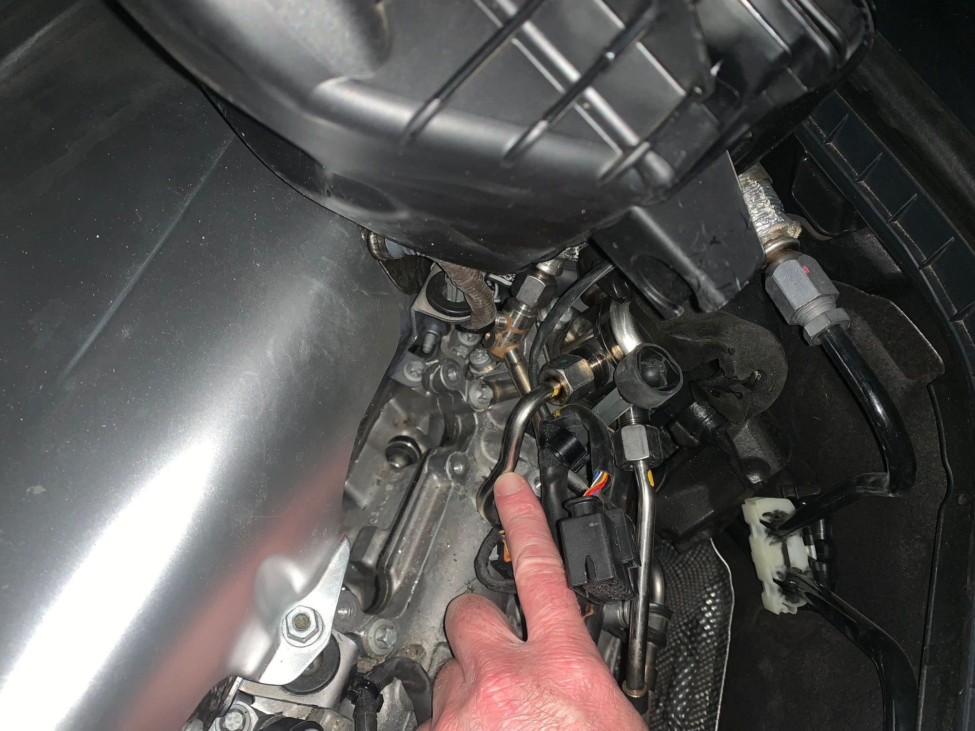

Hi, has anyone removed the coil packs on the M177 motor? what a ***** it is. I've done three but the last one on the right side of the motor looks to have a fuel or oil line in the way just wondering has anyone ever had to move it out of the way or just made it work? I managed to get it out but regretting putting it back in. Just wondering if anyone has a video on how to do this?
Is this a oil line, fuel line or air conditioning line?

It is a fuel line and I have seen that other people undo it when changing spark plugs. Put a rag under it so you do not get fuel everywhere. Also, might be good to have the car asleep and your key far enough away so that the fuel pump doesn't kick on and try to prime the system to be started.

You don't need to remove the line, you just need to get creative about maneuvering it out. it will take little time so be patient.
