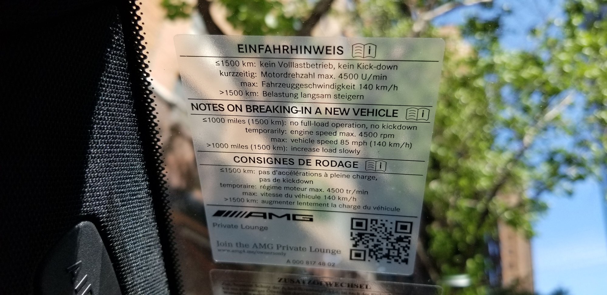

Last point in the breaking-in notes. You are supposed to gradually increase engine speed after 1000 miles. Don't just go WOT the moment you hit 1000 miles. Unscheduled oil changes are unnecessary. There's no break-in oil in these engines. The rear differential oil change is also no longer necessary unless stated on the window sticker.

I purchased my 2019 C63S coupe in early April 2019, it had the window sticker regarding the Break In Period and the Differential Oil change at 1,875 miles. (Photos below). I was also informed by Tech Advisor at that time to have the rear Differential Oil changed at 1,875 miles. The Invoice parts and labor was $278.05 with tax.
As for the recommended Break In Period of 1,000 miles? but I felt it took over 4,000 miles to where the performance and handling greatly improved. Now as I approach 17,000 miles the car is a dream to drive
