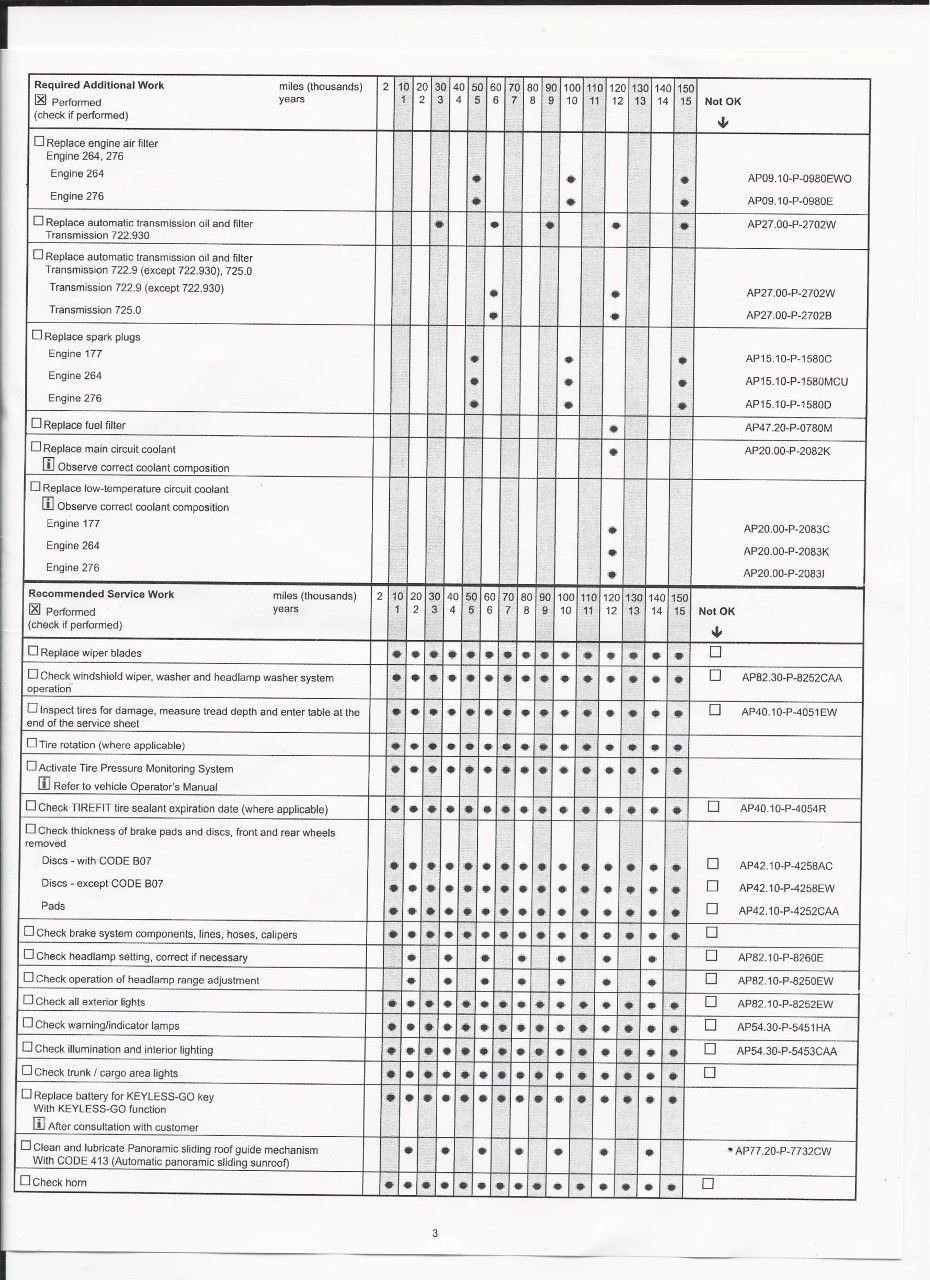

110 000kms in my 17'C63 whats next
I just clocked 110k kms, car is tuned by Velos since 60 000kms, without issues. Spark plugs changed around 70tkm, oil every 10tkm+ brake fluid, brakes twice, diff oil, and rear suspension twice.
No issues at all, what would you do as a service? transmission oil? spark plugs + coils? anything specific?
want to keep the car for 1-2 more years probably and theb Alpina B5 or M3 Touring.

According to the MB Service chart (photo below) the Transmission Oil and Filter change is due at 60,000 miles. Also the Cabin Filter change.
