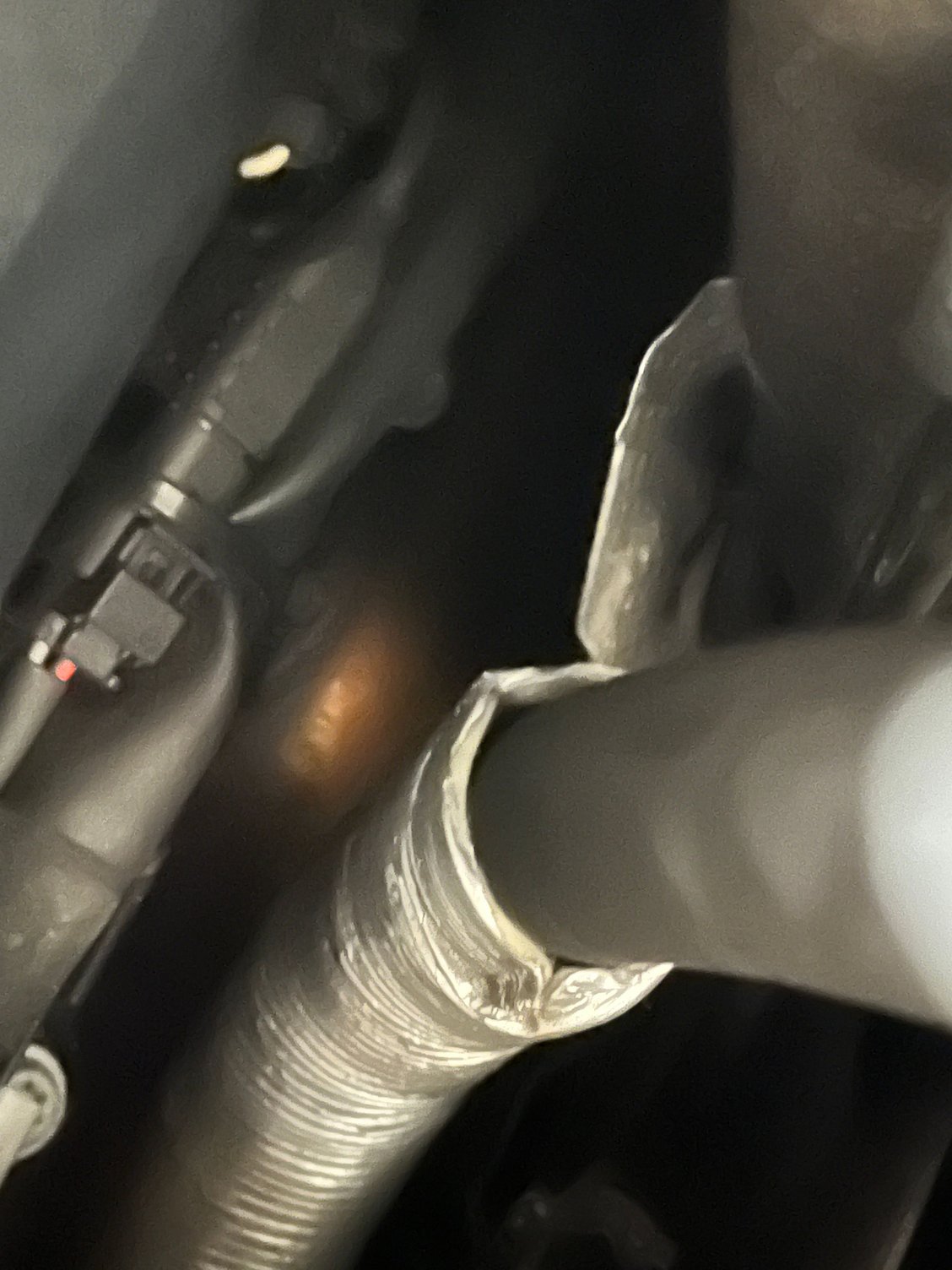

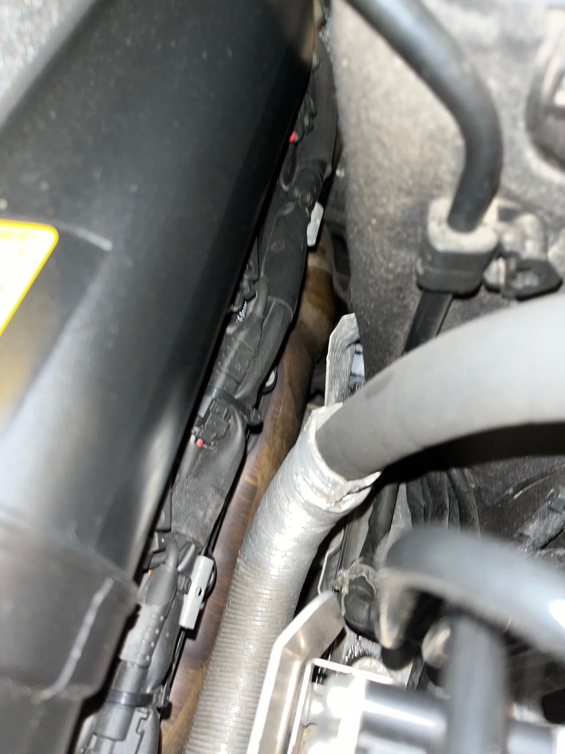

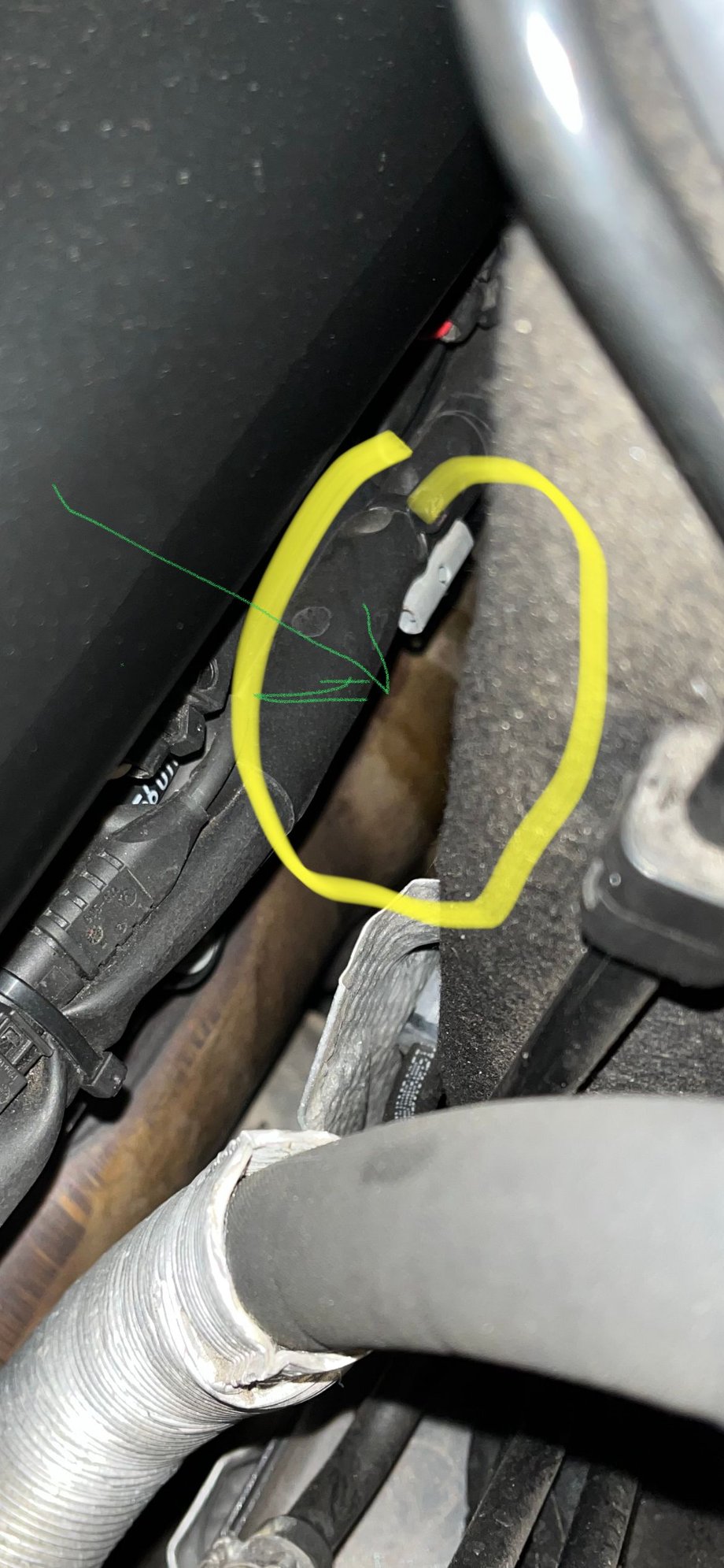

My C63 AMG Edition 507 (2014) has a slight burned oil smell which had developed and I think I have traced it to a drip on the exhaust manifold (rear/left bank) and this is finding its way though the cabin air intake. I’ve just had it serviced recently at Merc. So I was hoping they might have dropped a bit of oil from when changing it, but it’s unlikely that it would be here as it’s very far from the oil filler cap. I can see what looks like a wet/oil drip trail on the exhaust down pipe section. does anyone know what could likely be causing this? naturally big money worries come to mind!!! Picture attached, the best I could get…

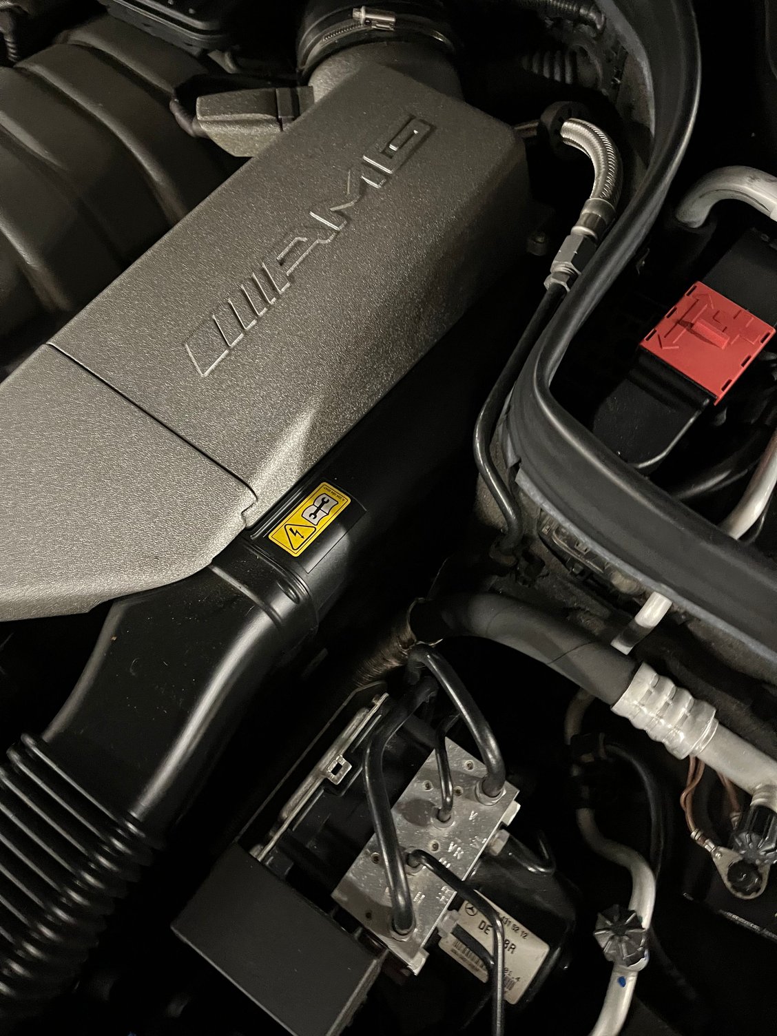

Valve cover gaskets leaked is well known issue on Mercedes. I personally replaced it myself on my Clk430, Clk500, CL55 and Slk56. Remove your air box and check the valve covers. It might leaked slow onto your exhaust.
