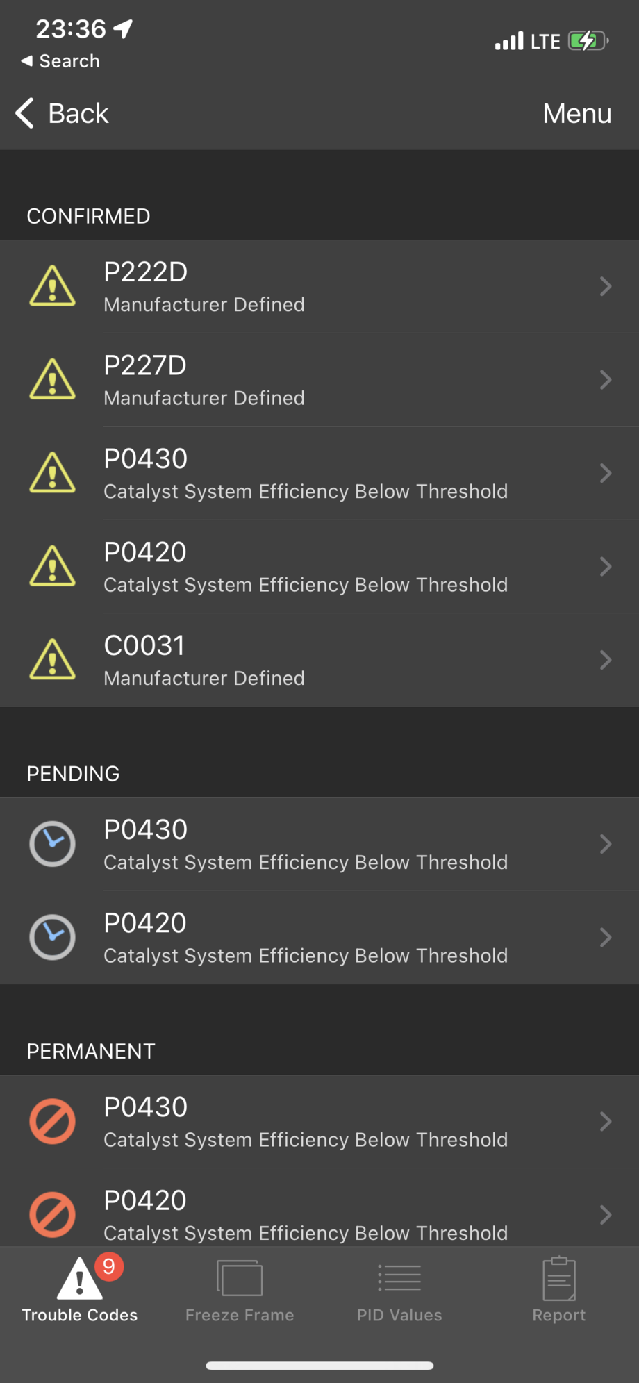

Had catless downpipes installed today, I’ve driven the car quite a bit but I still don’t have a CEL light which I was expecting.. at what point will it come on? Is it a certain Amount of miles driven? 🤔

Just put mine on last week, took about 300-400 miles in my case. Sport+ I was getting 10MPG still haven't gotten a tune yet.

It depends. Generally 75 to 300 miles for the light to come on. However, if scanned with an emissions ECU reader, o2 sensor codes will show virtually immediately (i.e. before a CEL comes on).
