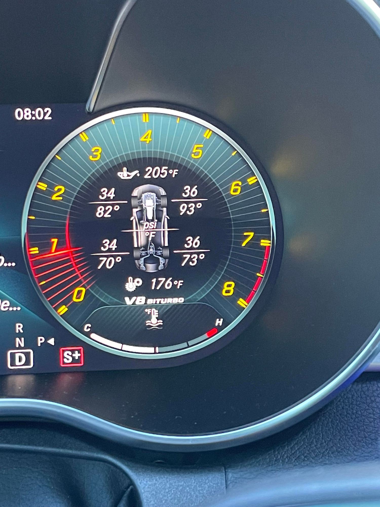

Passenger Front Tire all of sudden hotter any concern ?
Occurs ever time time I pull the Coupe out for a Spirited Drive

Has been discussed a few times. It's normal for that side to be 10-20F higher. Keep in mind the TPMS sensors don't actually measure the temperature of the tire compound. They measure the temperature of the air inside of the tire, which heats up from the brakes and other heat sources. It has been said that the exhaust is closer to that side and also as mentioned above a cooler that vents air into the front passenger wheel well.

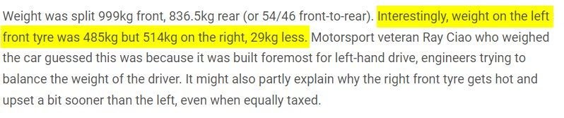

It's fine mate. Our cars are weighted heavier on the passenger side to compensate for the driver weight.
Reference:
Source: https://www.whichcar.com.au/reviews/...ng-term-review
