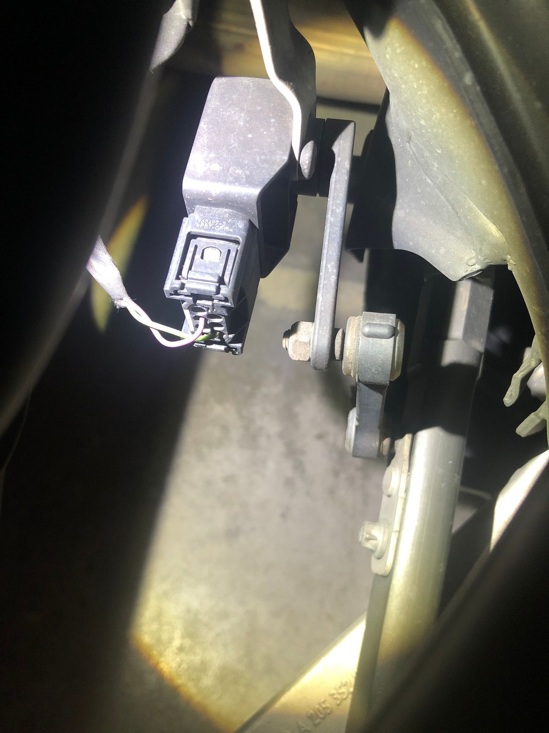

Anyone know what this is?
This is located on the rear toe link. Never payed much attention to it until I started doing deep cleaning from all the salt

Suspension height sensor?

Yes, that's the suspension ride height sensor. Tells the suspension control module the vertical position of each wheel to control the damping.

excuse my dumb question but is this more for air suspension? Vs coilovers in our c63. What is the functionality of this on our C, headlights leveling?

Nope, equally relevant. It's vital to know for the suspension control what each wheel is doing. The rate at which it compresses and rebounds, and at what level the wheel is relative to the others factors into the damping adjustments. This video talks a little bit about it starting around 1:30 and all the various other sensor inputs that are factored in.

holy! Never realized that much electronic/sensor goes into these type of cars
