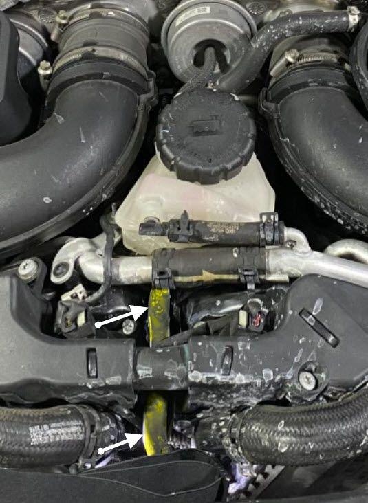

Yesterday, I opened the hood and found coolant sprayed everywehere as shown in picture [1]

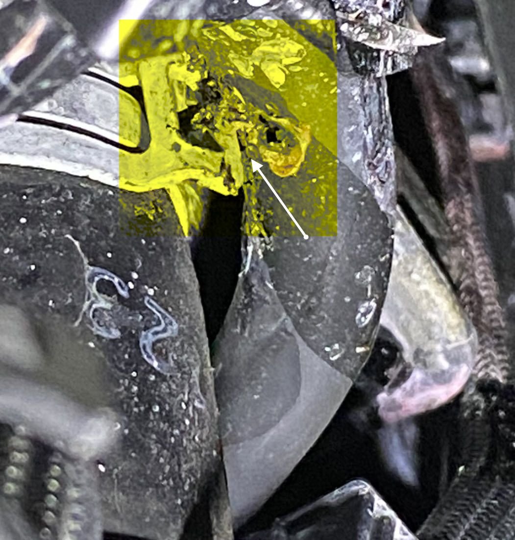

I tried tracing the leak and found that it is linked to a hose connected to the Turbo Collant Reservoir in picture [2]

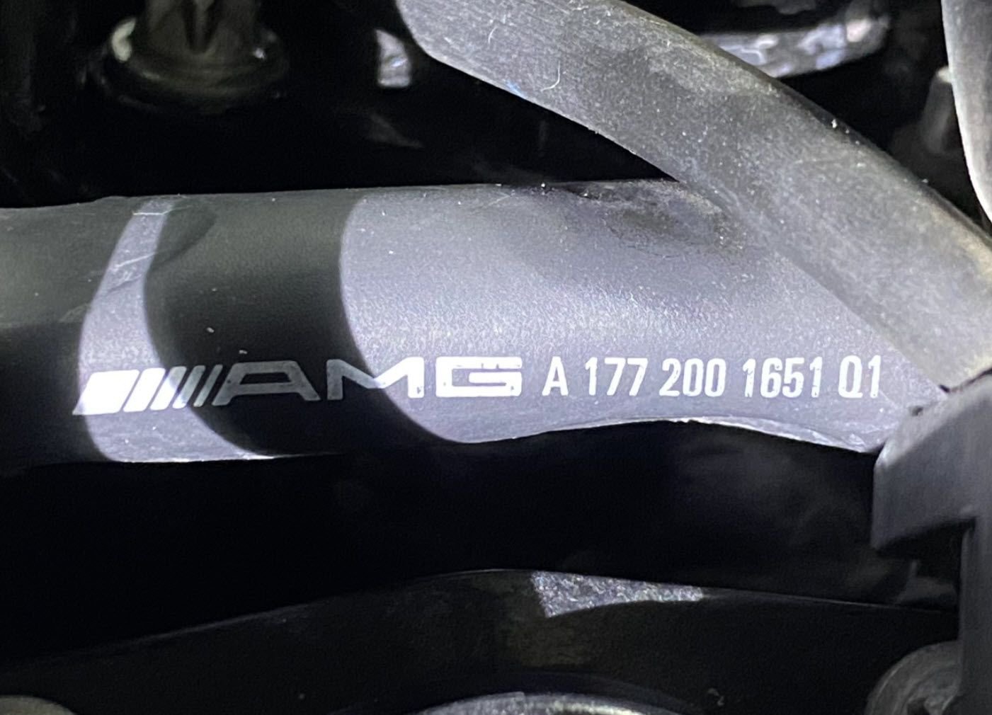

The hose was punched due to a closeby hose clamp which is really a bad design by MBZ as in picture [3]
I have attached the hose P/N in picture [4] as I cannot trace the other end of the hose and where it is going.
