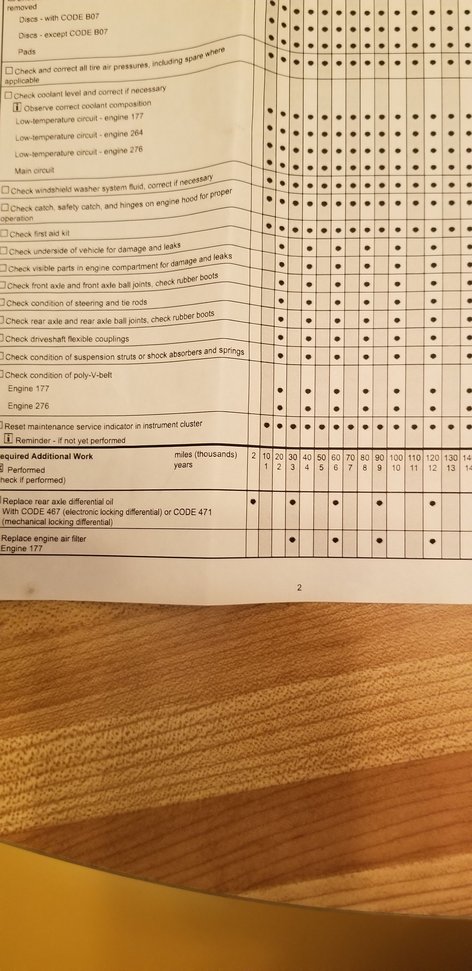

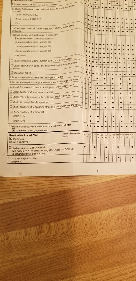

According to the MB Required Service Work sheet (photos below) the rear axle differential oil should be changed at 2,000 miles and then at 30,000 miles/3 years then at 60,000 miles/6 years then 90,000 miles/9 years and so on.
I just had Service A completed at MB Dealership for my 2019 C63s coupe with 18,399 miles. I purchased the car new in April 2019 so even though it's not at 30,000 miles it is 3 years. So I'm glad I saw your post. And the Dealership should have advised me.
I also see the engine air filter needs to be replaced at 30,000 miles or 3 years. For Engine 177.
