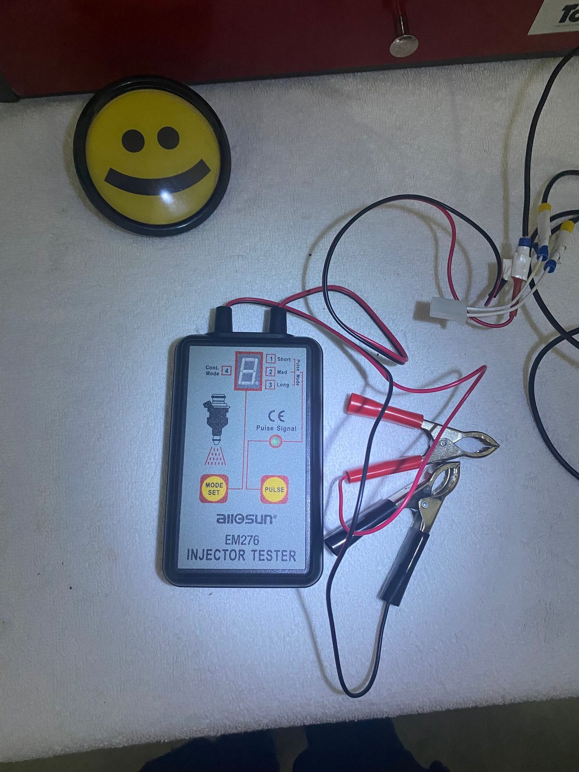

Pic below of an on car injector tester, NOT for Mercedes Benz, but for one of my race cars. The purpose of the funny looking box is to provide artificial known pulsewidth so a mechanic can "hear" an obviously sluggish or faulty/dead injector. It works off 12 volts and the injector connector is disconnected and the testers leads are hooked up with the car OFF (duh) and pulsed through various cycles. Continuous mode allows for quickly diagnosing outright bad injectors, pulse modes allow for various millisecond pulses to click the injectors on and off and by testing a couple of other injectors one can quickly "hear" a difference based upon pulsewidth sounds on "good" or "working" injectors. A mechanic can do 1, 50, or 100 pulses and "hear" whether the injector sounds ok. No fuel pressure is tested, nor spray pattern, this is strictly to test the injector duty cycle and changes to such, electronically.
If in doubt, replace the injector, which on our cars is kind of a PITA, but doable and reasonably cheap to do if this is the problem, versus just replacing spark plugs, coils, or whatever in the *hope* you solve the problem.
Anyway, good luck, and always remember it is easier for a mechanic and the profitability of the dealer or business to just start replacing *expensive* parts and hope things get fixed versus proper diagnosing and narrowing down of a relatively simple problem IF the mechanic is more than just a technician, and understands more than just what a scan tool might tell him is possibly wrong from a code. The codes can help narrow a problem down, but it takes some thinking to sometimes find and fix a seemingly intractable problem.
