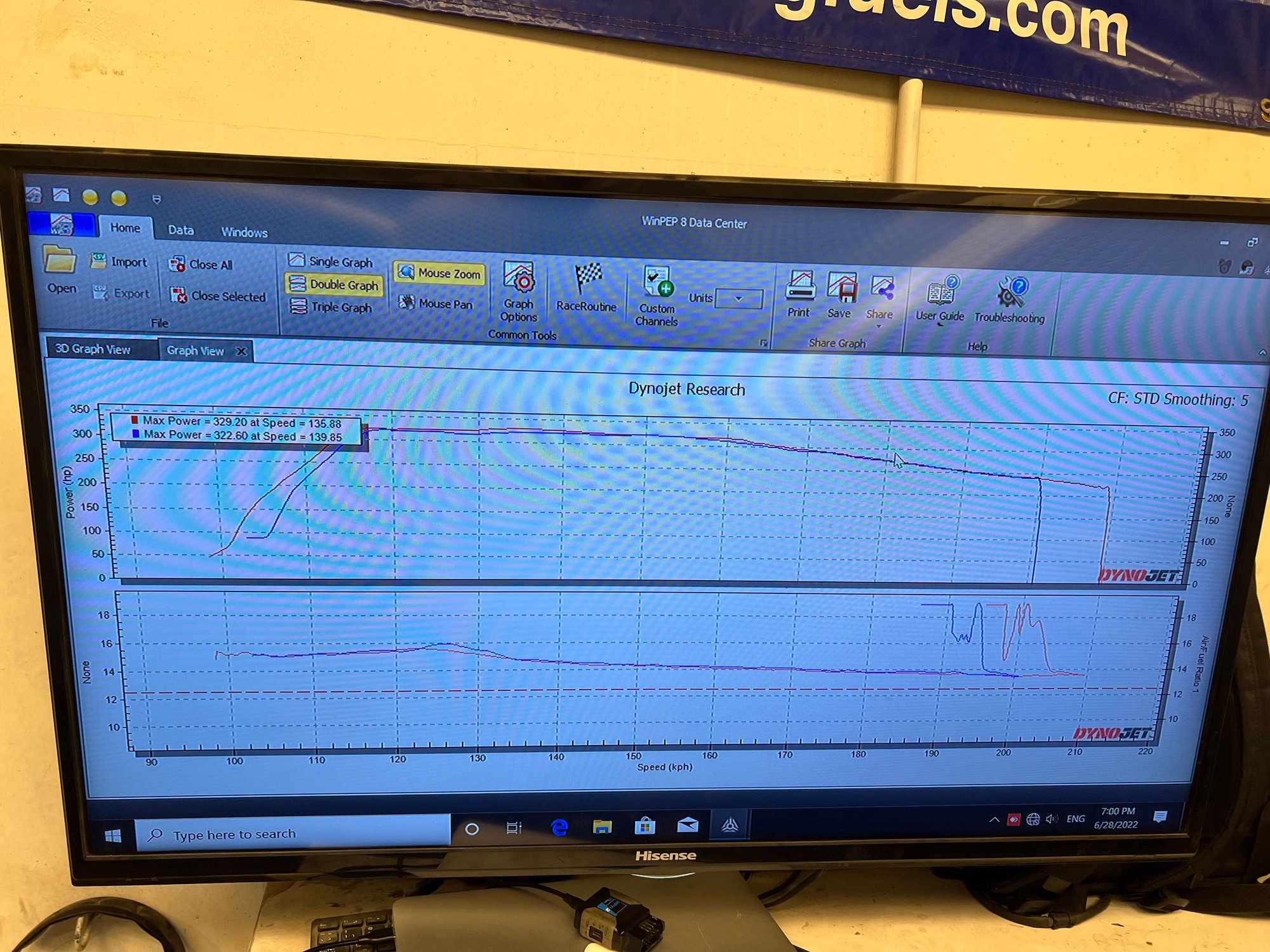

I’ve been checked many times there’s no fault code only sunroof code !!!
330 hp

All temperatures are normal but the datalog shows that problems with gas bump or mybe injectors
and the boost is almost zero at high rpm, about 1.7bar
but i see that the boost screen when i accelerate run good with no lag !
