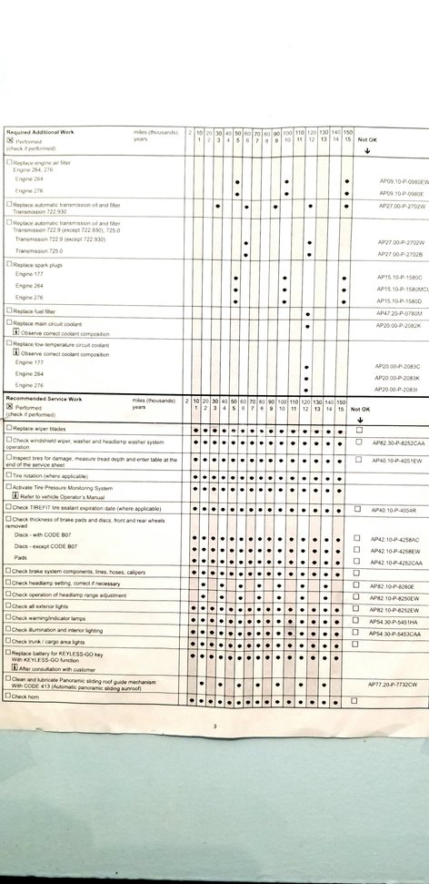

I was given this MB Required Service Work sheet for 2019 C63s coupe.
Believe missing page 1 but below are 3 photos of required Sevice Work either in Miles(thousands) or Years, listed at the top of each page.

One of my main questions right now is whether or not I need to change the transmission fluid. How do I tell if I have the 722.930 vs 722.9 vs 725.0?
Big difference in mileage between them. And for reference, I have a 2018 C63s Sedan with 38K miles.

You have a 722.930
