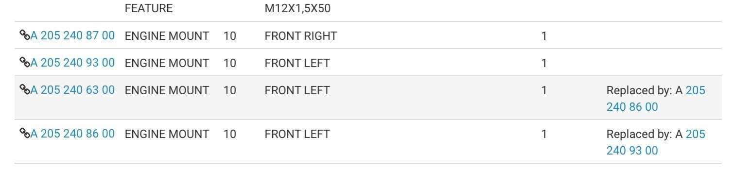

That's too much. Mercedes in Australia only cost $2500 brand new from the dealer.
These shi*ty engine mounts are known to crack especially in the early prefacelift versions.
There's been several revisions for the LHS have been done as they always break.
The current part numbers are:
A2052409300 left
A2052408700 right

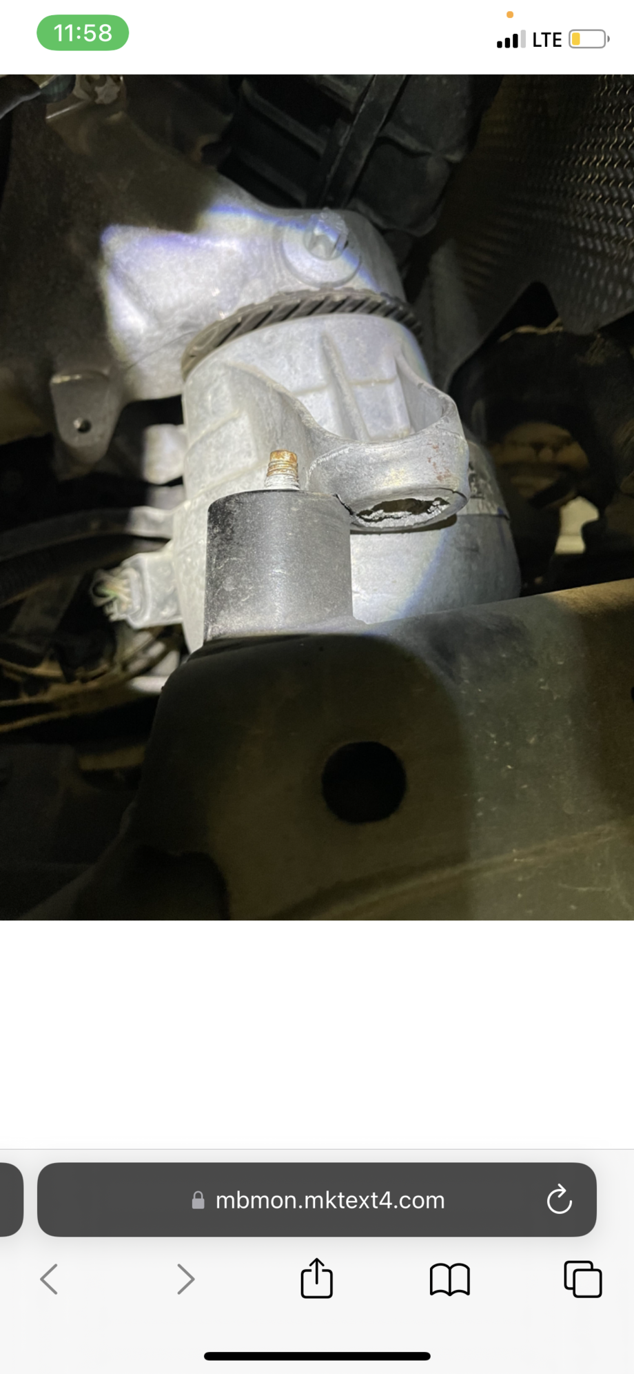

Here are both of my cracked engine mounts on my C63 S Coupe which I drove with for more than a year.
The only symptoms I noticed from having broken dynamic mounts was the occasional THUD sound on takeoff and also when putting the Suspension mode in SPORT+ upon returning to COMFORT suspension it still felt stiff. This would happen each time I used the harder suspension modes.

Thought id post to let you's know
there has been new revisions again to the mounts
A205240930064 LEFT LATEST
A205240940064 RIGHT LATEST
