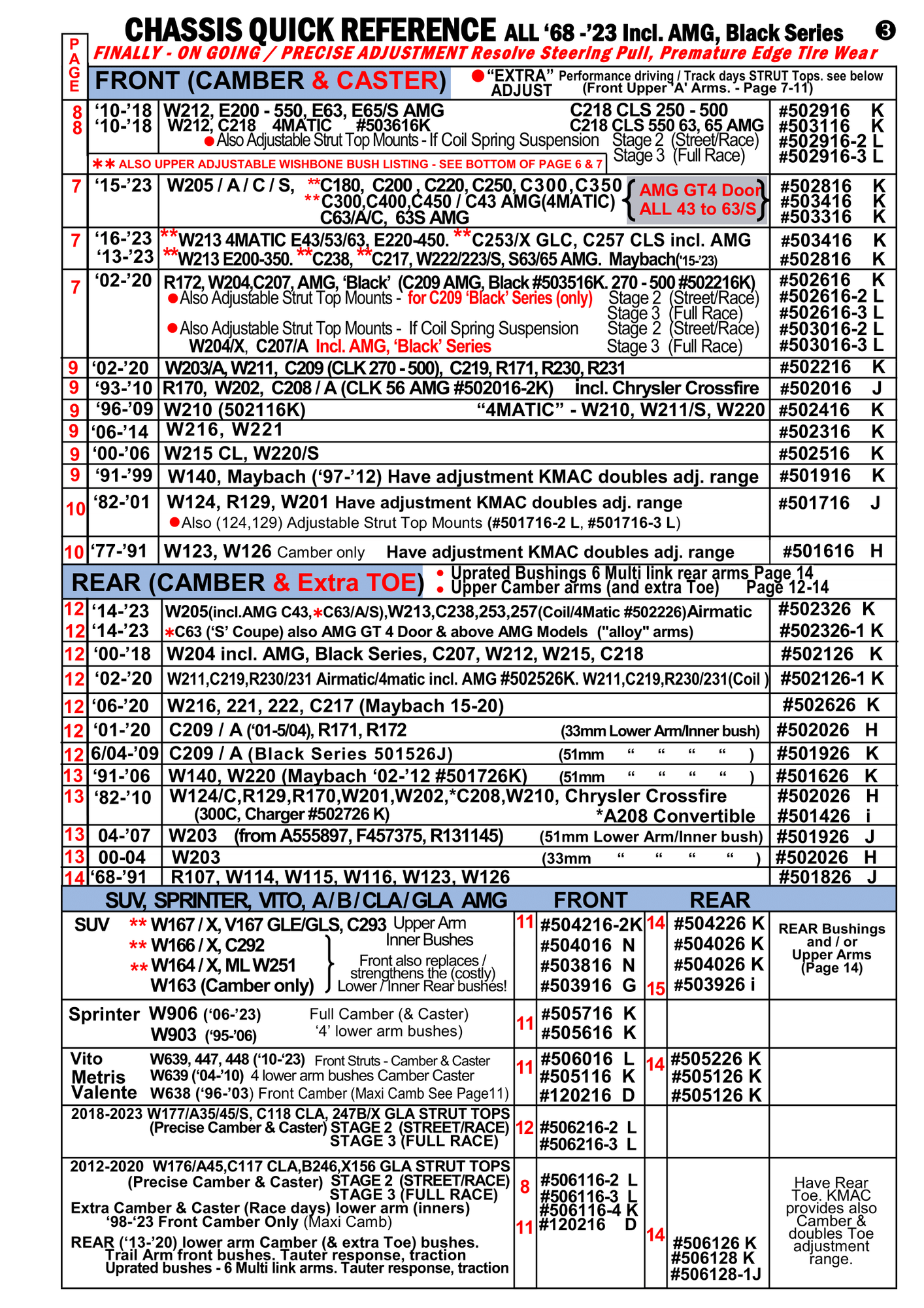

Originally Posted by koifysh
want to make sure this is the rear camber kit for 2018 c63s coupe correct? Want to make sure before I place an order. This would replace the stock rear upper control arm?
https://k-mac-camber-kits.com/produc...r-camber-arms/
BACKGROUND RE - W205 C63 S “Coupe”:
Rear (Camber & Extra Toe) adjustment #502326-1K.
This is “separate rear kit” to the C63’S’ sedan and wagon (#502226K).
We manufacture both upper arms and lower arm adjuster kits. Plus Strut Adjusters (Front & Rear to suit all Mercedes Benz Models 1968 to 2023)
Strongly recommend lower arm adjuster kits (Especially for C63 S “Coupe”) !
CHECKLIST:
1) Upper arms more difficult to fit.
2) Then also time consuming to adjust (and accurately).
3) Plus to resolve costly, premature excess inner edge tire wear - top of tire needs to adjust “outwards” reducing important clearance top of tire to outer fender.
4) C63 ‘S’ Coupe all upper arms OEM are fitted with spherical bearings. Only rubber is the ‘2’ Lower forward facing thrust arm bushes (K-MAC uprated replacement for these is #502628-1F).
COMPARED TO LOWER ARM ADJUSTMENT:
5) Fit without need for wheel or arm removal.
6) Retains important clearance top of tire to outer fender.
7) Ultimate adjustment - “direct on alignment rack under load”. (With easy access single wrench fast accurate).
8) Soft rubber OEM bushings then eliminated from rear suspension (other then #4 the ‘2’ thrust arm bushes). Further eliminating rear end flex, loss of traction.
NOTE: C63 S “Coupe: - The lower arms “inner bush” has OEM shim plates. You can purchase a offset plate but one position / inaccurate and only providing minuscule 3mm (1/8”) Camber change. K-MAC bush replacement provides serious adjustment - to fix it right the 1st. time with ‘4’ times the adjustment range and as described above precise accurate adjustment (under load) direct on alignment rack. This kit (#502326-1K) also includes extra ‘Toe’ -doubling the existing adjustment range.
Kevin

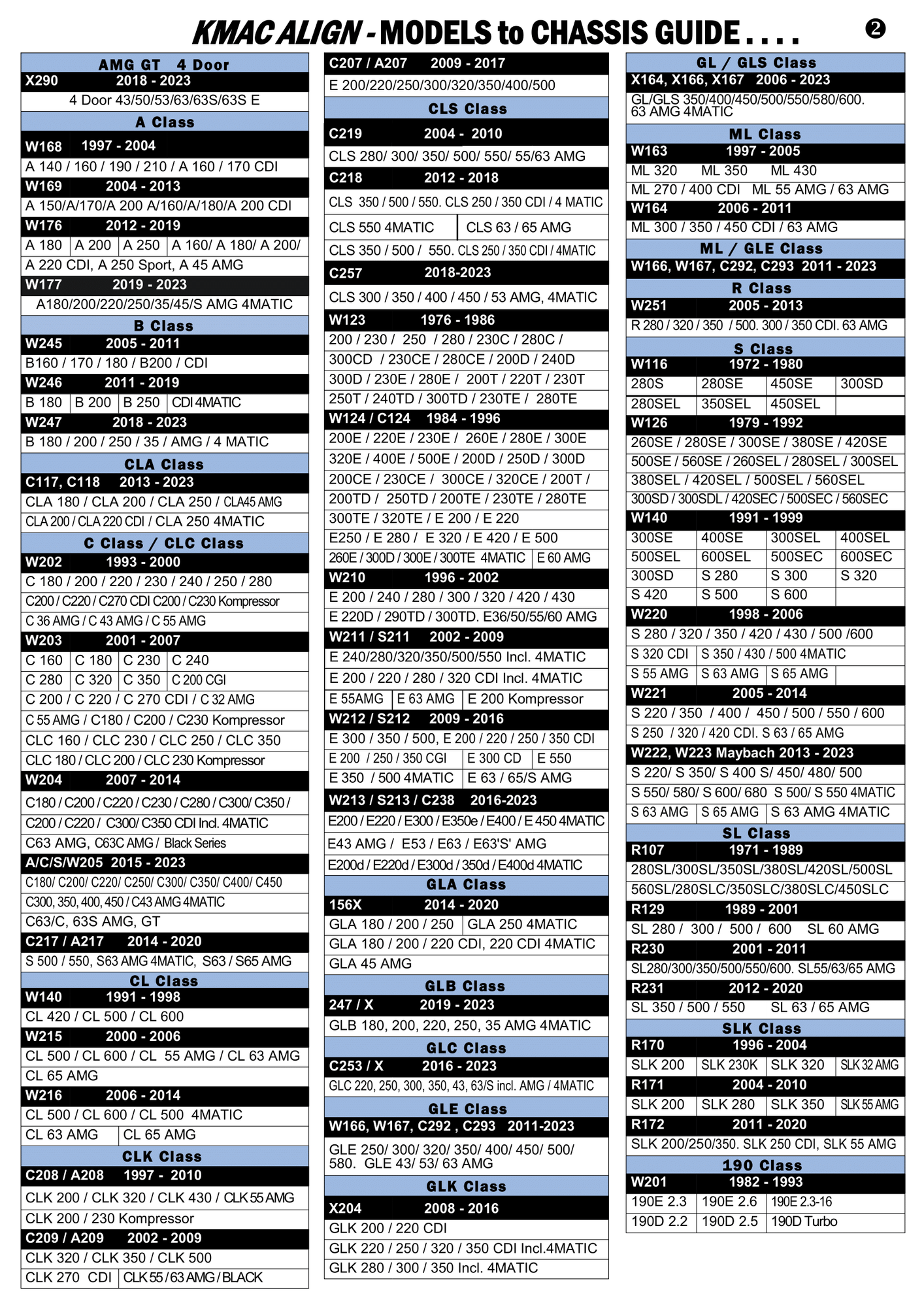

Yes, that’s right !
We do our proving on the race track in all out competition - big heavy V8’s. Main straight full speed then hitting corner race curbs - fully launching. Then slamming down broadside lap after lap !
Kevin
Have attached (See Spoiler) “Chassis Guide” along with “Quick Reference” sheet on Front and Rear kits covering virtually all models.
Front kits are Camber and Caster. Rear kits are Camber and “extra” Toe !
Note: Front kits add –1 after P/N if require Camber only (see Website and/or Catalog re complete listing).
