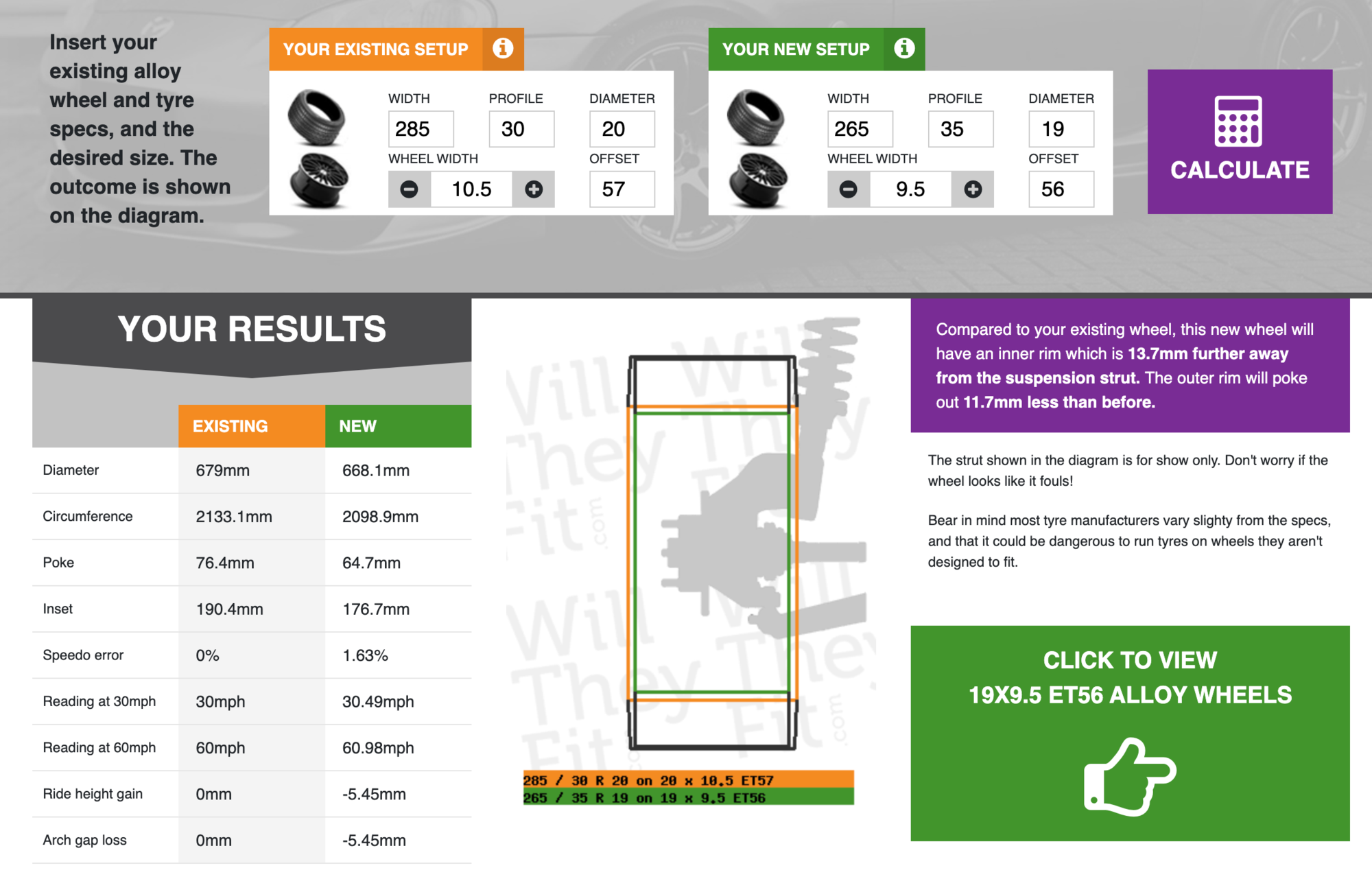

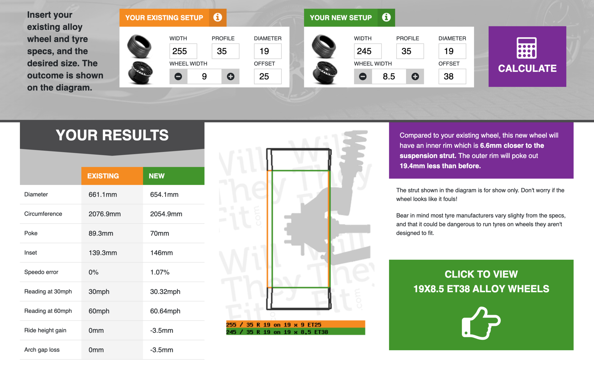

Hi All - I'm new to this forum but have been lurking for a while. I just traded in my 2020 C63S Sedan for a 2023 C63S Coupe. I have winter wheel setup from my 2020 sedan on factory 19" wheels. The coupe has the 19/20 staggered setup and I'm trying to determine if the existing winter wheels I have will fit on the coupe. According to willtheyfit.com (screenshots below), it seems like they should albeit slightly narrower and with a very small speedometer discrepancy. Has anyone run sedan wheels on the coupe? Anything I should be aware of?
Thanks!
Front:
Rear:
