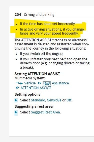

That's normal. It suspends itself for various reasons that are listed in the owner's manual and it's only active between 37 mph and 124 mph. It's really only active when driving at mostly constant speeds for a long time. For less than 30 minutes of driving, or if you drive in a sporty manner, or simply changing lanes and vary your speed it will suspend itself. I've personally never seen mine active when I checked and I've never gotten a warning to take a break even on road trips up to 12 hours. I'm apparently a highly attentive driver, but on long trips I mostly use DISTRONC and that's another thing that triggers the suspension.

Thanks, good to know there not an issue. Just picked up the car and learning my way around
