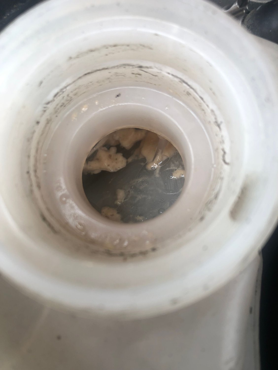

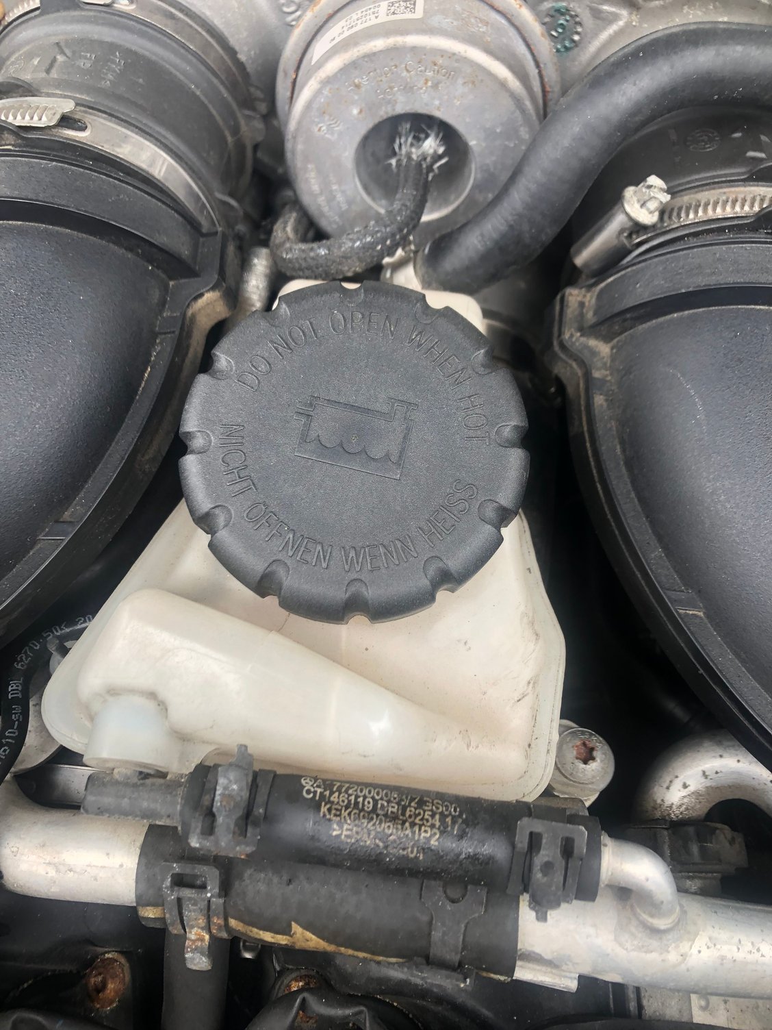

Has anyone experienced low fluid and gel texture in the 2nd tank between the turbos? I believe it’s coolant for cooling the transmission?

Mate any chance you could post a photo? Would help so we can see. Jelly substance can happen when you've never had a coolant service and different mixes of coolant added in or an additive has been used like a pour-in radiator sealer.
Flush the sh*t outta that coolant system man and check for any leaks and fill with proper Mercedes coolant.

Do the cheap fix first and flush it out like Jimmy said. In my BMW sludge like that means a blown gasket that released oil but since the middle is for transmission it could just be a bad mixture?
