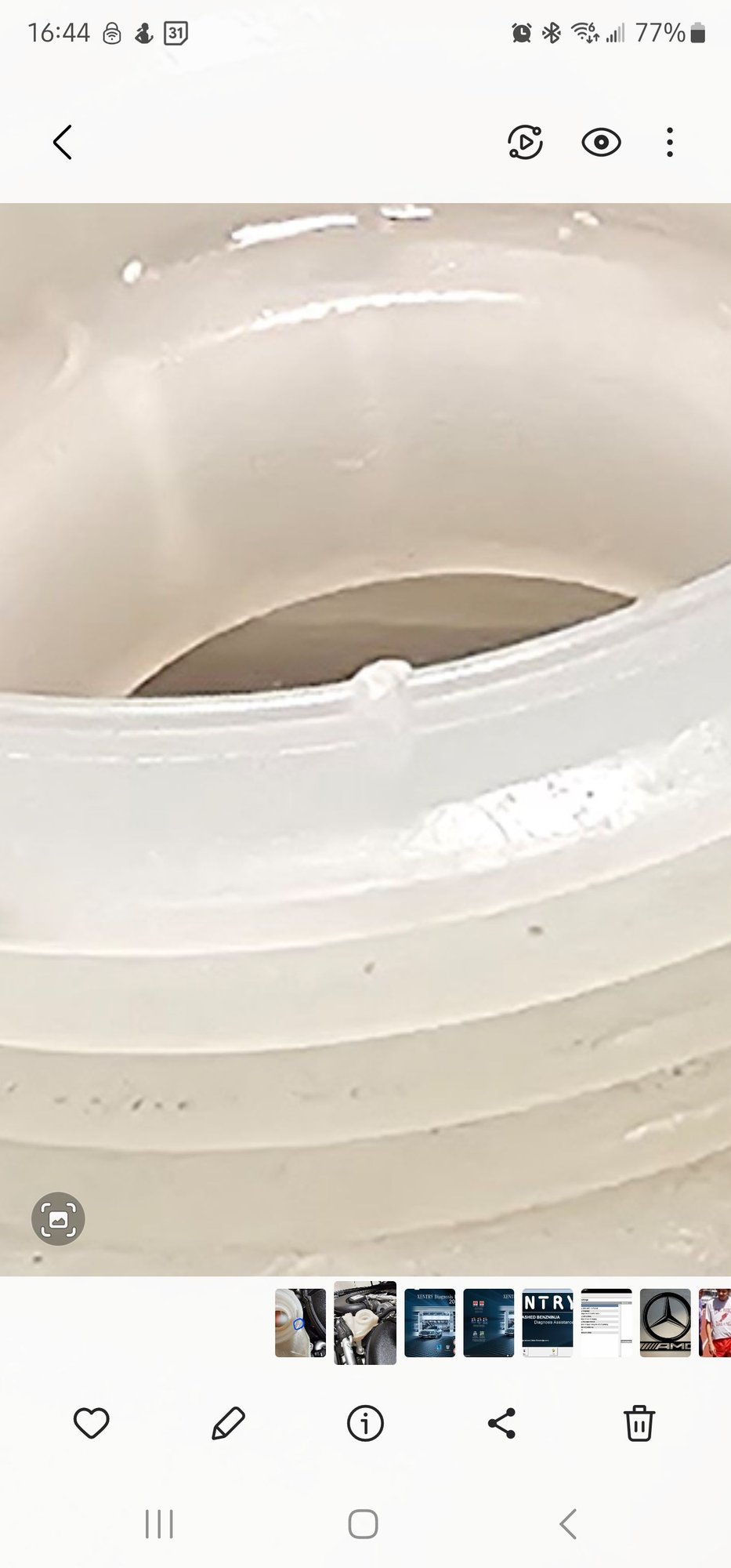

Old Apr 29, 2024 | 07:10 PM
Roysup's Avatar
Joined: Jan 2024
Posts: 201
Likes: 60
From: Colorado
2018 C63S AMG Coupe, 2019 Jaguar F-Pace SVR
I had the same thing with a very slight smell of coolant when it was parked in the garage, but no leaks whatsoever. I checked my coolant caps for crust and found some on the smaller reservoir by the turbos. Noticed a very small ding in the top of the reservoir and was able to smooth it out and lightly file the top edge flat for an even surface around the whole circumference. So far the smell is better... I guess some vapors might have been escaping, but no liquid?
