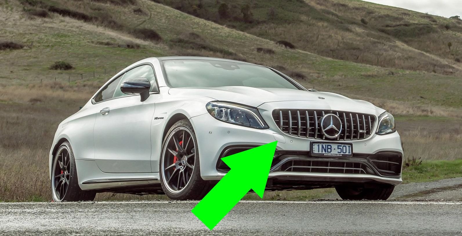

Did you say you put the front number plate over the towing eye as in where the green arrow is? If so then this will trigger the pre-safe collision due to the distance sensor right next to it. The Star is for distronic (cruise control).
So what I did now is I got a new tow/plate holder made for the C63, and instead of having the plate offset more towards the middle of the car, I have it flipped an under the headlight. So far today, it has been fine with no incidents of it setting off the braking system. I think it might have been the first one I used was really long (the pole part) and had the plate literally like 6" off the front bumper.
I don't believe the ultrasonic sensors in the front bumper have any relation to the emergency braking. Theoretically they could be used, but these sensors are not even present unless the car was optioned with the parking assistance package. The emergency braking is standard, even if you don't option the parking assistance package, so it can't depend on these sensors.
