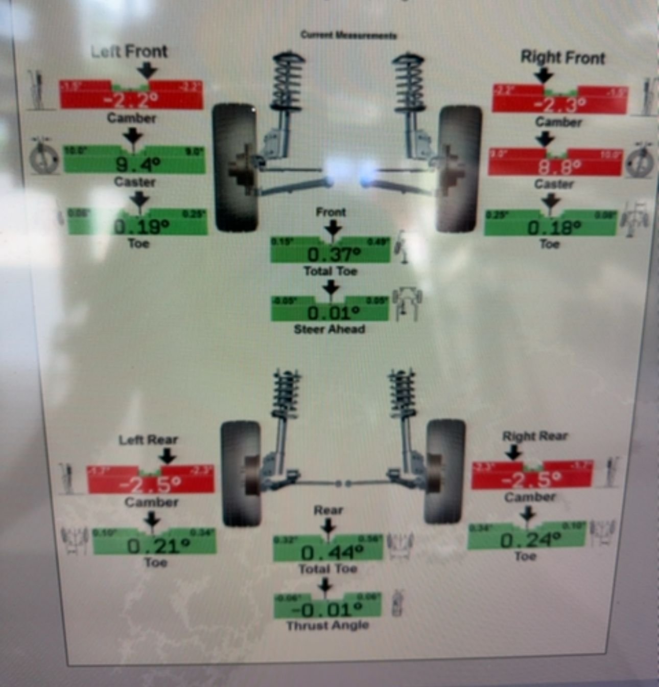

Good Afternoon,
I currently own a 2019 C63S AMG Sedan, Vehicle is lowered on H&R Sport, I have been dealing with the vehicle being loose or not as planted on the ground/ skating over 120mph, I have rebalanced all wheels aswell as had a suspension shop tightened all suspension bolts and go over it all, please look at attached alignment as it seems chinese to me and let me know what I can do to fix this issue. Thank you

-2.5 degrees camber is very aggressive for the street. All 4 of your tires are leaning inward at the top, leaving less contact patch on the ground when driving straight. Therefore, at high speed you have way less contact patch on the road and it is probably contributing to the loose feel. Your camber spec would be great for lower speed AutoX... Or aggressive full track use. But for a street car it's pretty high.
Your front toe-in seems good, but it looks like your left rear has a little toe-out and your right rear has a little toe in (picture is a little blurry) ... Overall the rear has a good total toe-in, but that left rear toe out might be also contributing to that loose feeling you describe at high speed. A tiny bit of Toe-out (in the front) feels great when turning into a corner on a track but makes the car feel loose at high speed. Toe is adjustable.
The way to fix the camber is with KMac's bushings, so that your camber is adjustable and you can set it to like - 1 to - 1.5 degrees.
