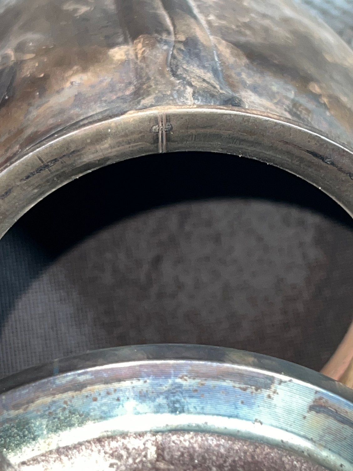

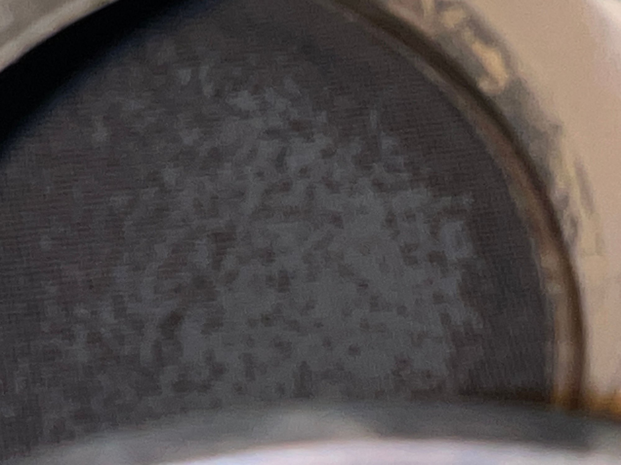

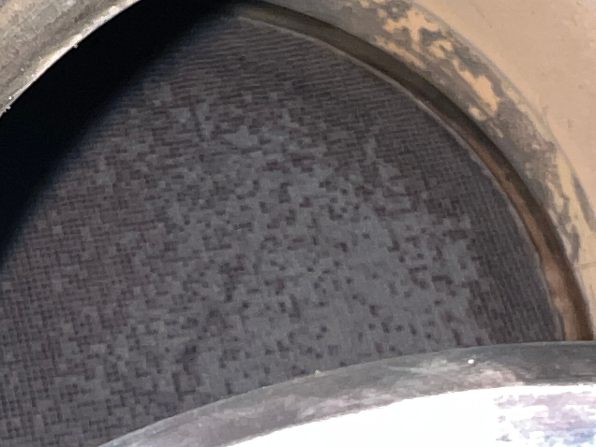

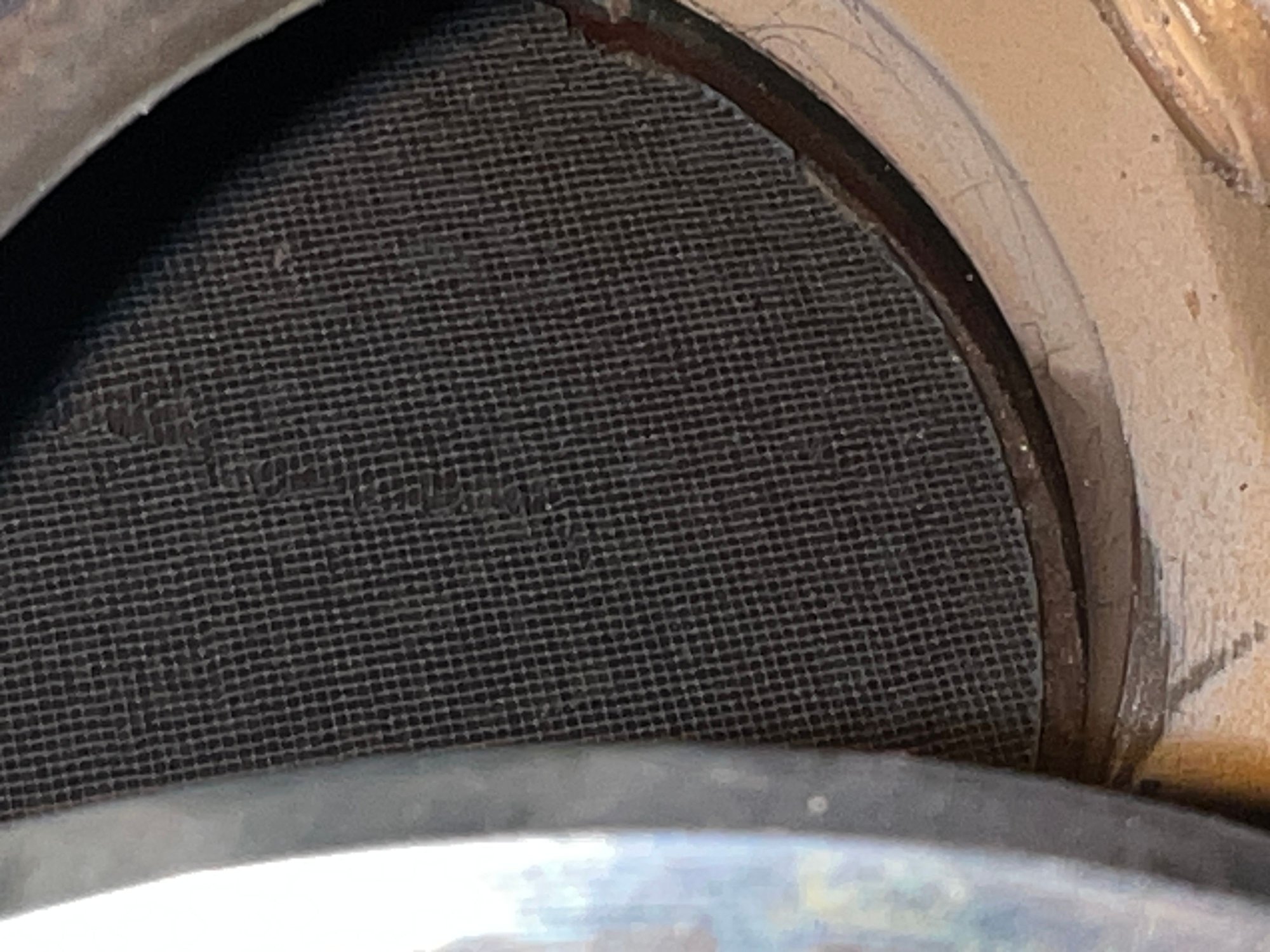

Hell im new in amg world I bought a second hand car i did some maintenance on it first it got codes p02177 cams adjusters and from time to time check engine with p0430 and since i bought it car a bit sluggish in C MODE OR bit slow response on throttle only in C MODE so what i did we diagnosed that to change all 4 adjusters and the chain we checked it it was ok everything from the mechanic done about changeing the cams adjusters codes was stored now they are clear but from time to time still got cat code Iive checked them they where cloged as in my country fuel also not always good so im still suspecting that this issue should be from the cats them slefe might be melted I tried to remove the secondery ones but is still the same so just asking any expiring about this

thanks iive changed the spark plugs and some of the coils car it feels better but still the issue for sure im still looking for the car catalyst i was trying to find OEM ones but it found out I need to left the engine and headache so im wondering if the after market downpipe with cat that it comes with 2 peaces and new o2 sensors can fix it
