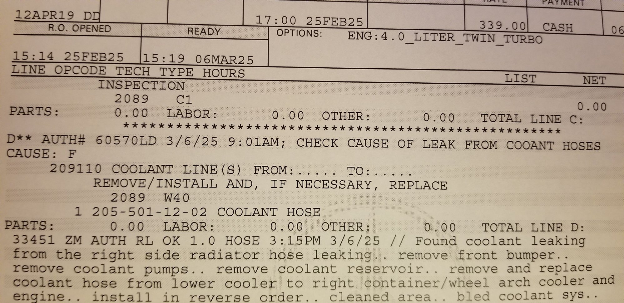

My 2 year Mercedes Benz Extended Warranty expires April 11, 2025. The car seems to be running fine with no noticeable leaks on the garage floor or any other issues.
However about 2 weeks ago I brought it to an Indy who had replaced my brakes/rotors in the past. He did a complimentary inspection, before my warranty expires, and noted that the upper/lower radiator hoses were leaking and the radiator should be replaced. (Photo below).
So after this inspection I immediately drove it to the MB Dealership and after being there for 9 days they repaired the issues noted and all was covered under MB Extended Warranty. (Photos below).
So if you have a Extended Warranty that is close to expiring it's a good idea to get an Indy inspection prior to the expiration date and have any and all issues that will still be covered under warranty. Glad I did. Include the original Dealership 4 year waranty.
