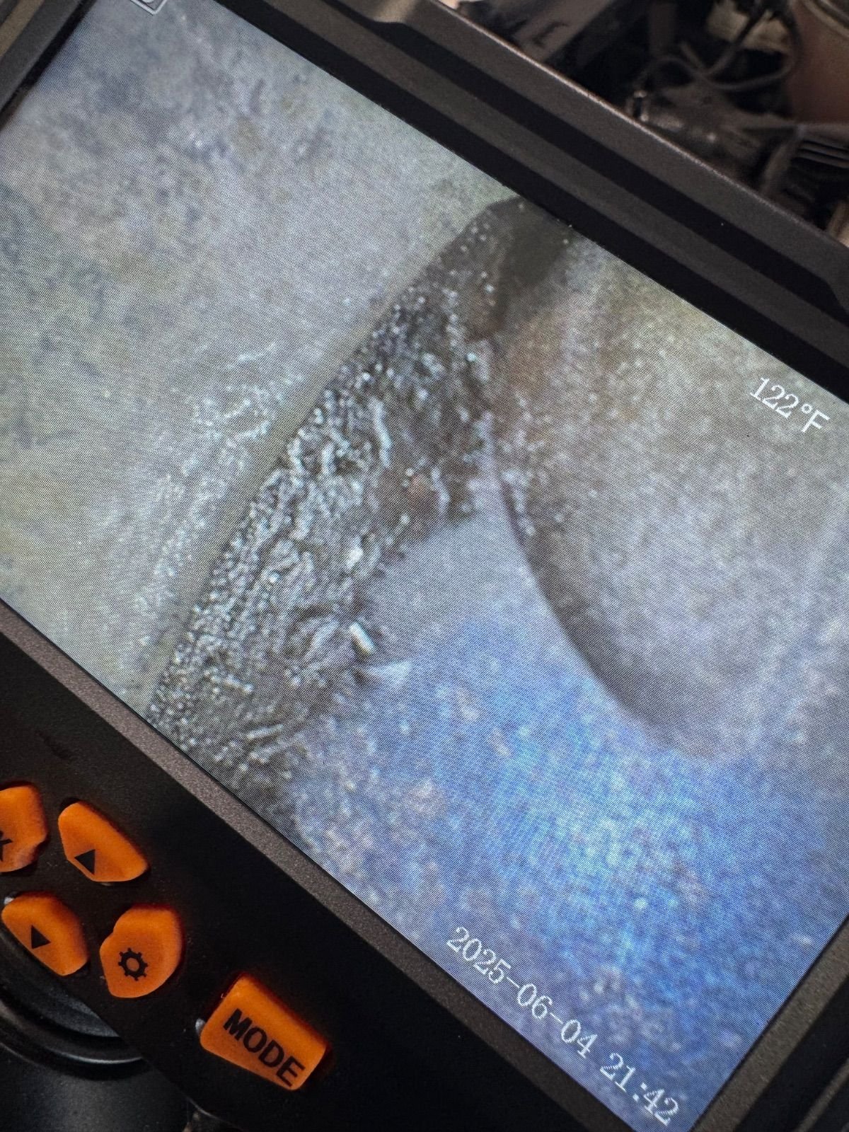

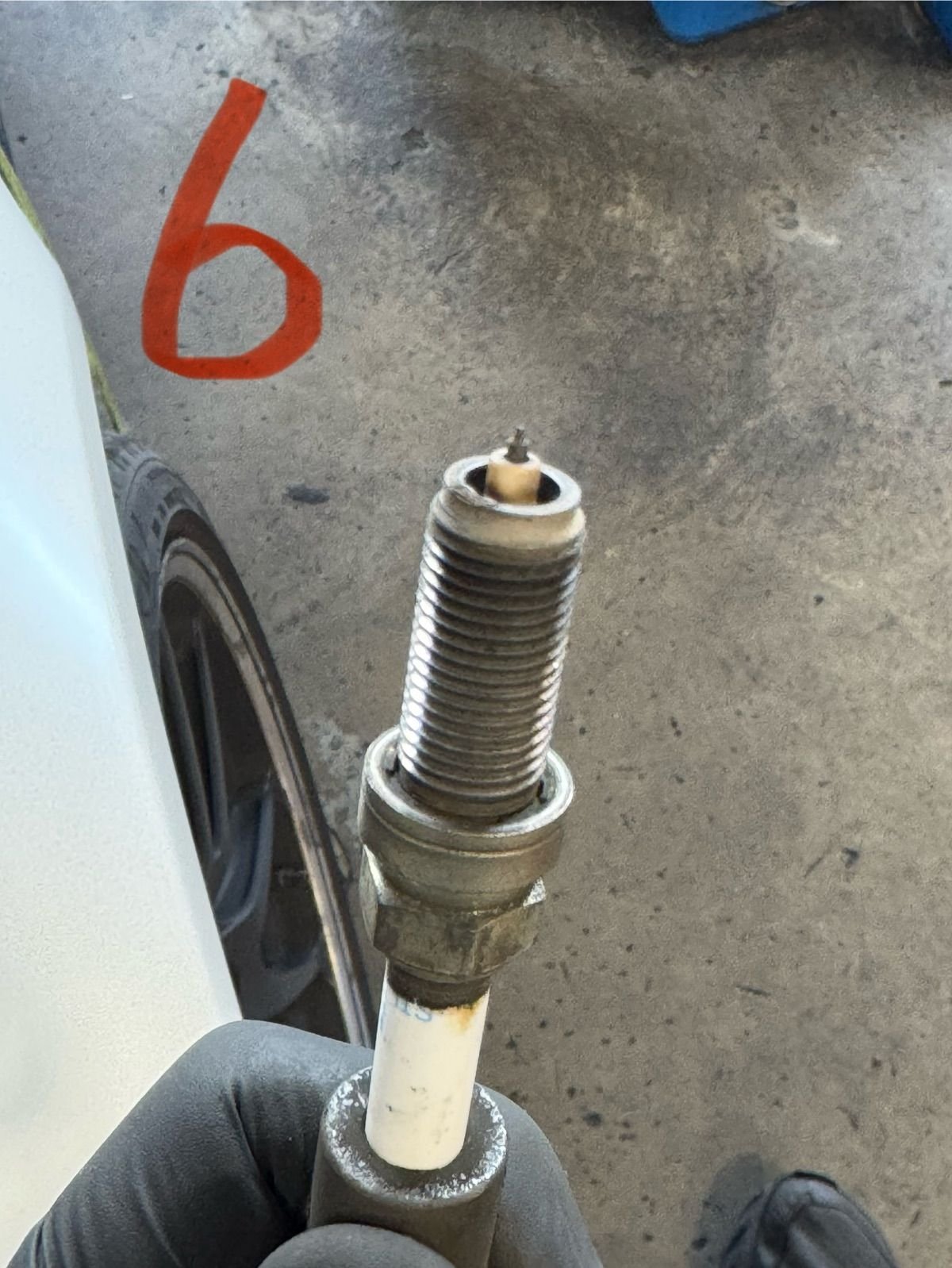

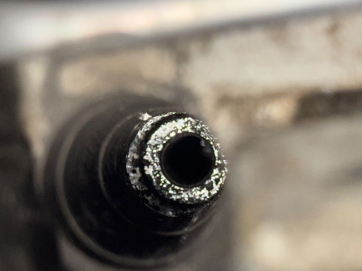

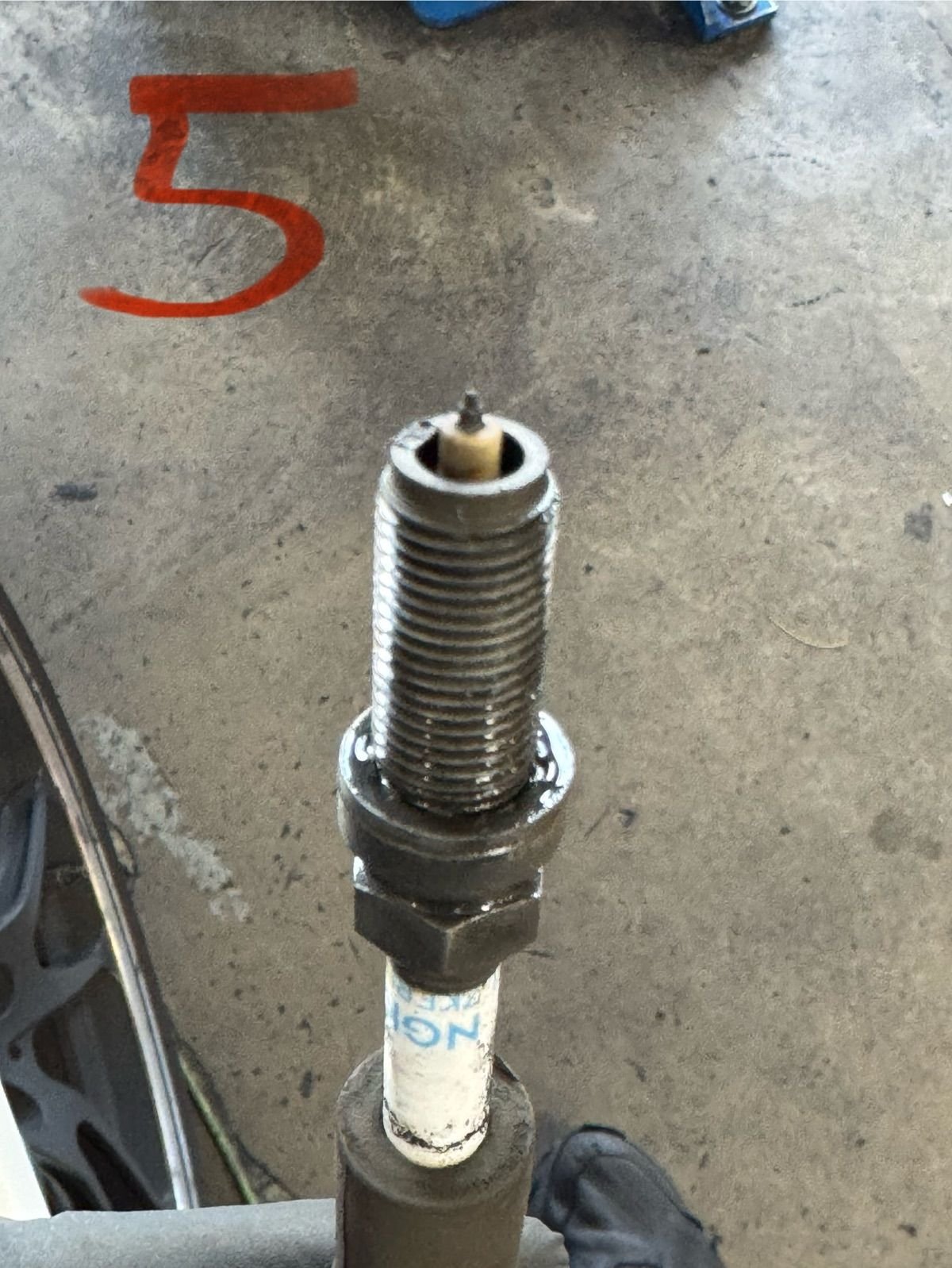

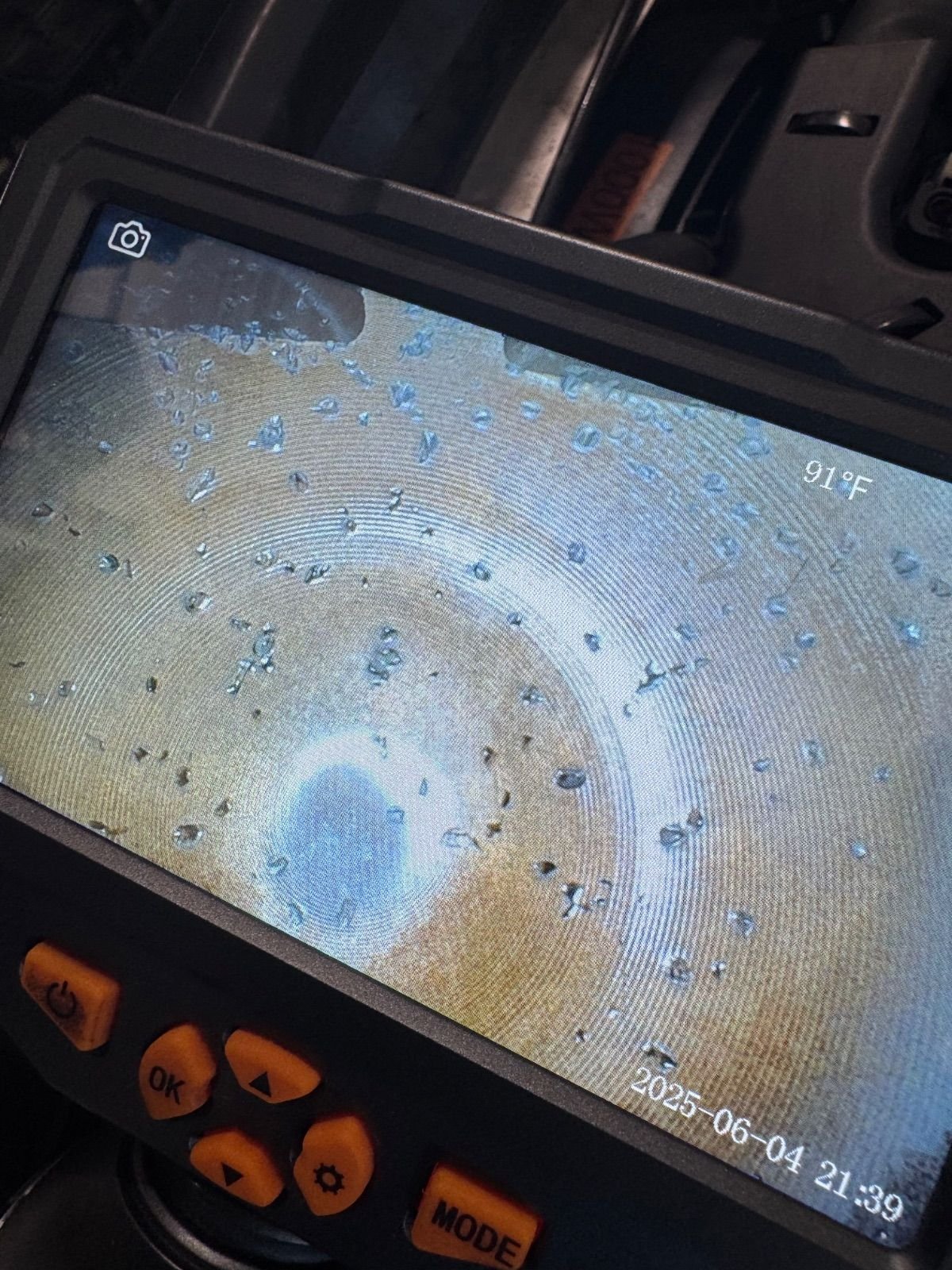

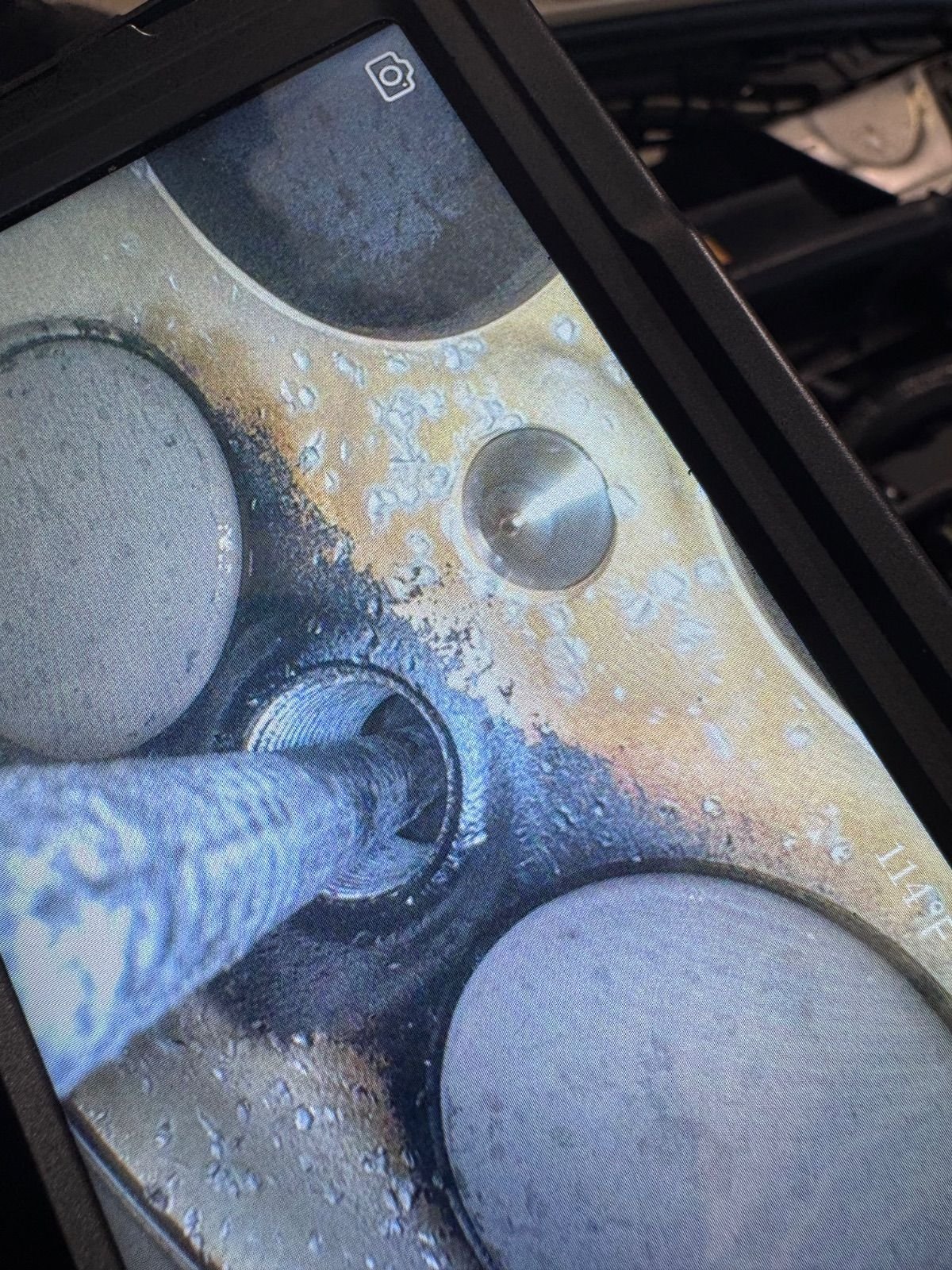

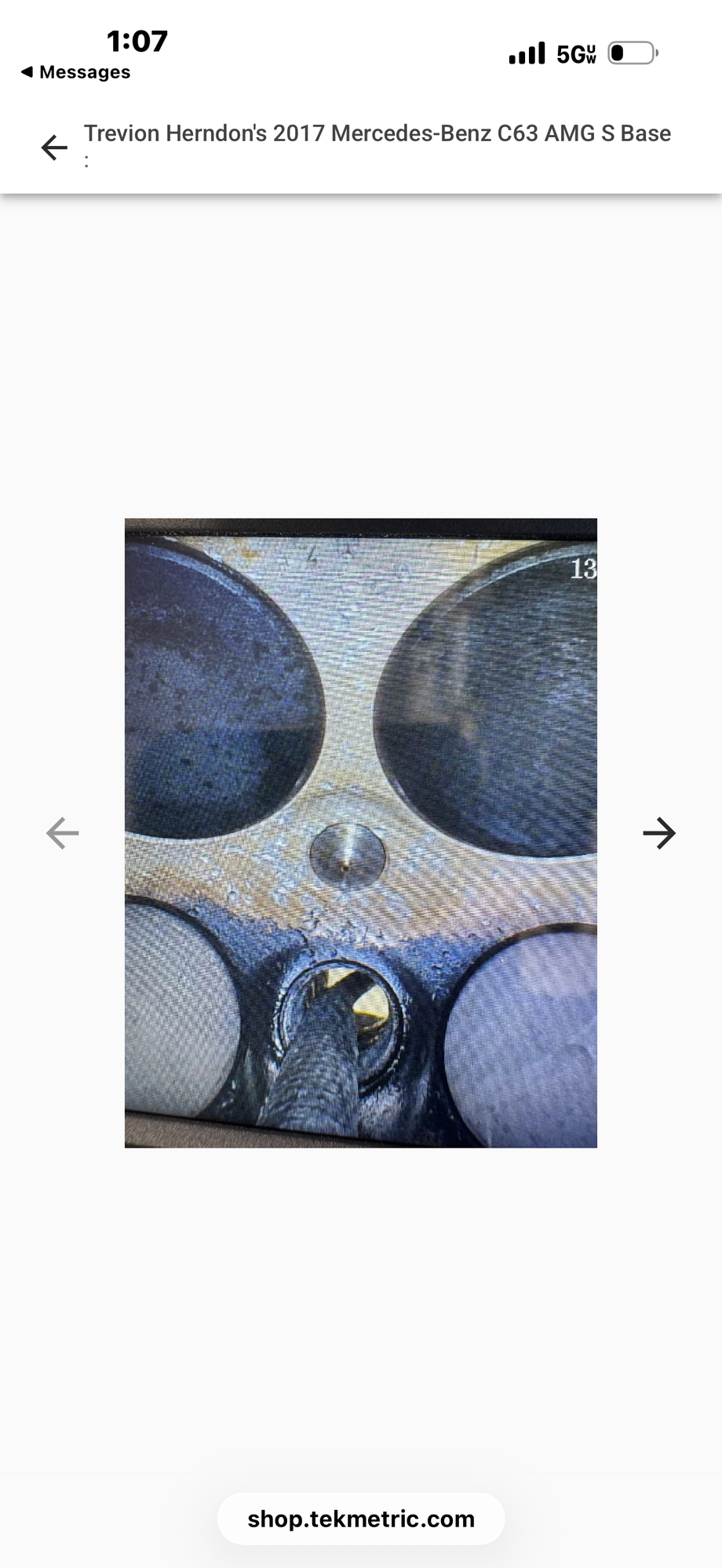

Short story spark plug for cylinder 5 and 6 code p21a0 I had misfire for 5 and 6 checked spark plugs were popped out the spark plug L igniter fell into cylinder head 5 and 6 threads are fine replaced spark plugs for 5 and 6 code went away for 6 now cylinder cylinder five is still there coils are fine fuel injectors are fine I was told the head needs to be done will the head being refurbished fix my problem picture of spark plugs and borascoop picture of head

Okay, the electrode from the spark plugs is broken
end now somewere in engine , cat etc ?

On the pictures i see damage on piston from broken electrode.

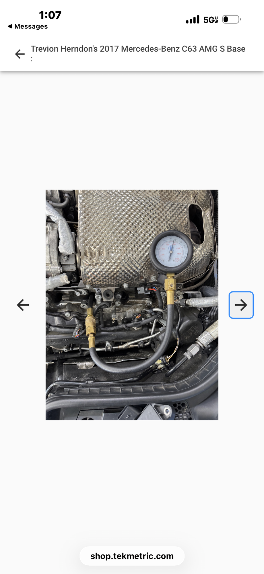

Compession is ok you say ?

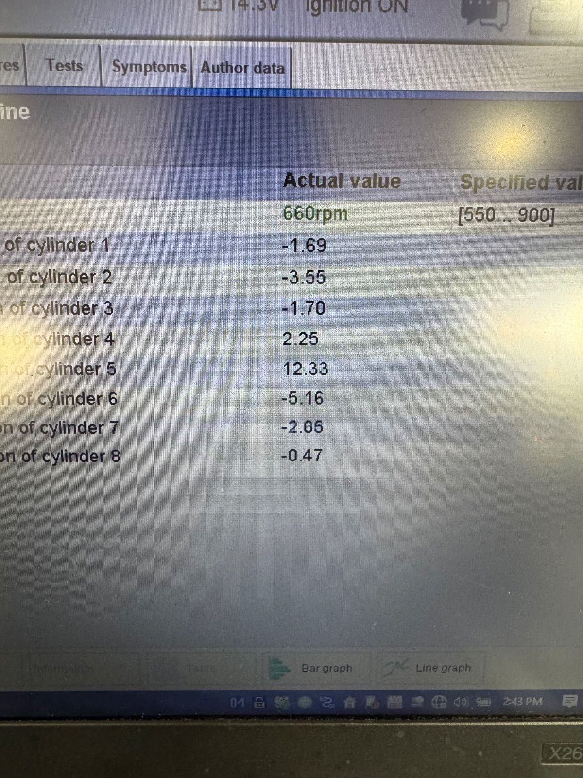

P21A0 ~ Fuel/Air Mixture (Cylinder 5?) Unbalanced.
Is the car scanned by MB Xentry ?
This oem scanner gives more accurate
and unambiguous findings.
Only cyl 5 has code P21A0 furthermore ?
coils injectors 100% ok and no wrong air etc or something else ?

First you should finde the electrode ( near cat ?) then
check valves valves seats etc all the way electrode has gone .

It looks like you had a borescope camera to look around in the cylinder. If the spark plug ground strap wasn't in the cylinders then it probably exited through the exhaust.
You can see that it bounced around in the cylinders a bit, and so that makes me worried it may have damaged valves or valve seats, tip of the injector, etc.... However, the compression test shows it's at 150 psi. I think that's okay, maybe a little low, but the bigger question is does it hold that pressure or leak? If there is a damaged valve surface or valve seat surface that psi will leak down pretty quickly, and then, yes, you need to remove the head and have a valve job done. Some leakage is normal, because air can get past the rings, but very slowly.
If the spark plug ground strap exited through the exhaust the next thing in the way is the turbo exducer wheel, so when you pop off the downpipe to see if the broken piece is sitting on top of the cat, you should inspect the turbo's exhaust wheel blades.
The whole point of finding that spark plug piece is to make sure it's not still in the engine where it can cause more damage.
The bigger question before you put new plugs in it and give it a try, is why you had 2 spark plugs fail. Were you running low octane fuel? Maybe pre-ignition cause those to break. Are you tuned? Maybe the spark timing map is off.
