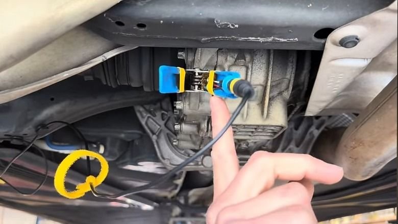

First thing that's done is diff fluid inspection by getting the rear diff oil drained and checking the magnetic drain plug plus the oil itself for significant glitter, metal particles or chunks. If there's a decent amount of debris that’s pretty strong confirmation of internal wear.
Next to be 100% sure the “boo” sound actually coming from the diff (and not wheel bearings or something else) use chassis ears or a mechanic’s stethoscope on the diff housing, pinion seal area, axle tubes and wheel bearings during a road test or on a lift.
Here’s what they look like
Ask the shop for any photos or notes from when they had the diff out and whether they can properly open it and document the internals (gears, bearings, etc.) before finalising the quote.
Also, ask if they scanned it with Xentry/Star (or equivalent) and saw any diff lock codes. Do this and you can confirm it's the diff without jumping straight into a big job.
