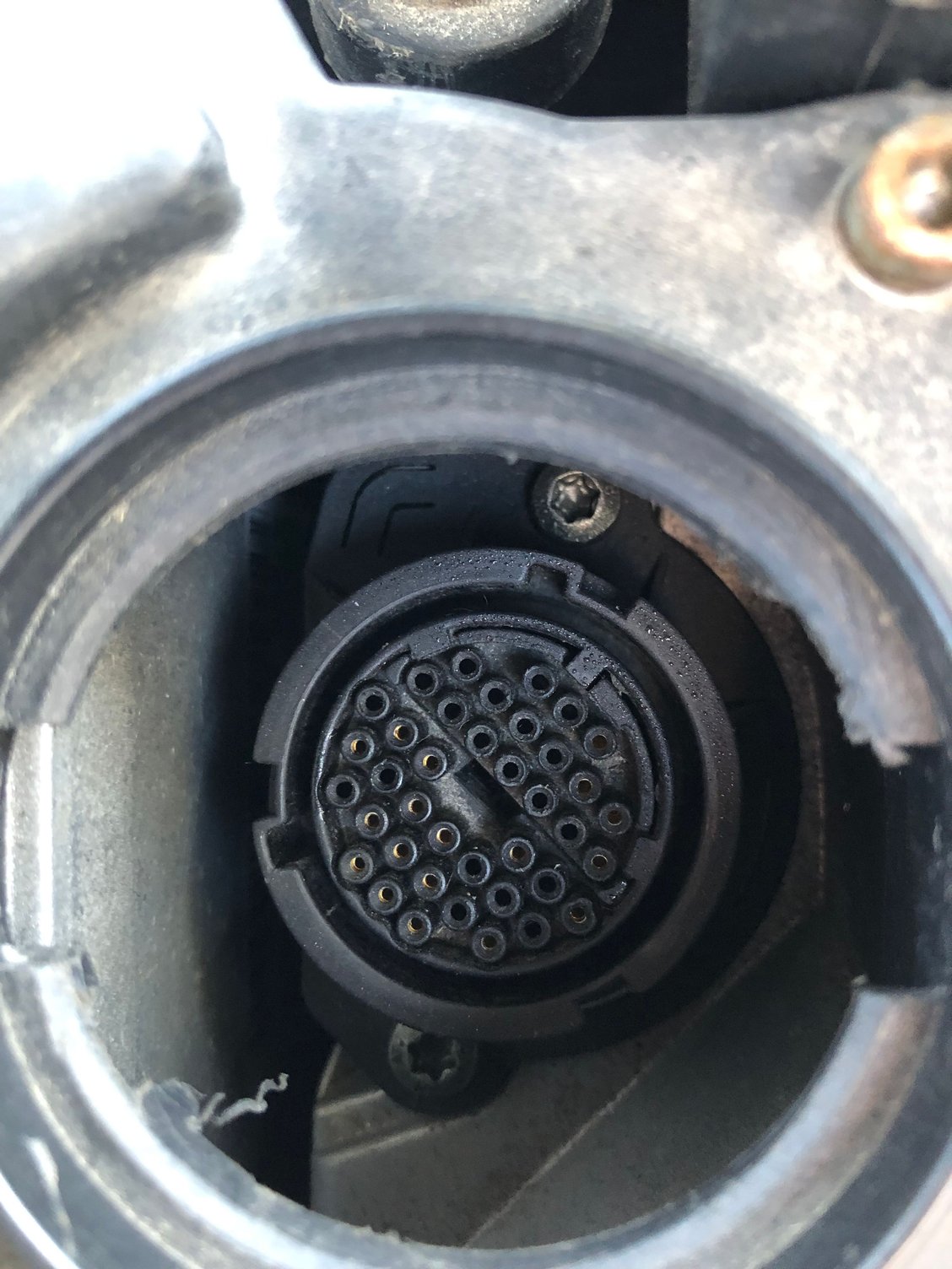

First thing to check is your OBD connector, as 1995 was the transition year. Do you have a 16 pin trapezoid shape connector somewhere under your steering column?

No is the older style on the fire wall under the hood.
