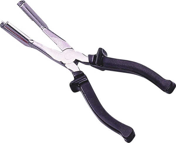

on 2000 CL500... how difficult is it, should i take it to sevice?

if you have tools you be done in an hour
no tool 2.5 hours and might rip the wires out
hahahaha
here is the tools
http://cgi.ebay.com/ebaymotors/Merce...ayphotohosting

wease, have you used this tool? Also, is it that much more difficult to get the boots off w/o using it or something similar? Jud

yes I have. Here what happen I 1st use my hand by the 4 plug my hand started to hurt(thats only 35min into it) so I stop, I went to my brother's house and borrow the tool can back home with in 45min into it i have change
12 plug with no pain. with that tools all you have to is grib the tip on to the plug and pull.

Thanks, I'll get one.
