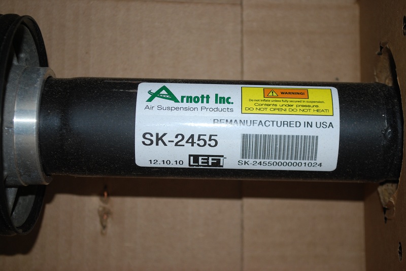

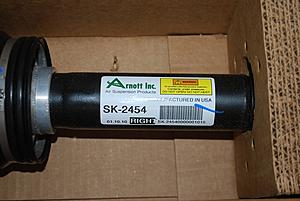

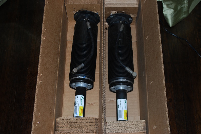

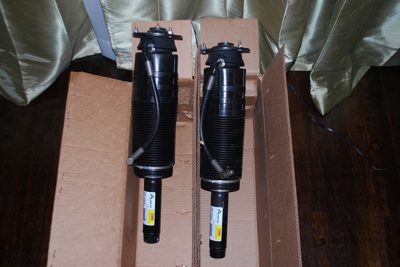

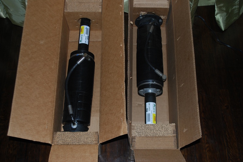

Shocks arrived today, and will be installed Saturday by my Indy. He also said he can calibrate the ABC system to lower the rear 1", and the front 3/4". The shocks from arnott industries looked great. The upper rubber mount of both front shocks are broken.
