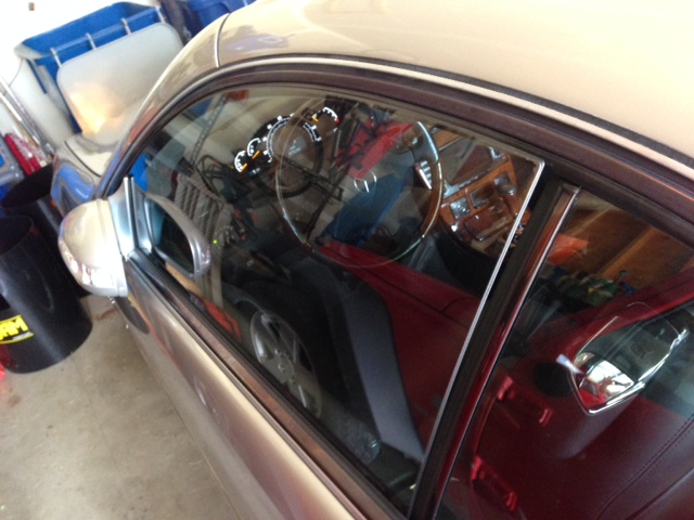

So I disconnect the battery for an hour or two. I reconnect it and synch the windows. All four work great. Then, about two days later, the drivers side rear window stops going up the final 1/4 inch or whatever that amount is. About a week later, the drivers side front window stops going down the 1/4 inch or so it needs to when I open the door, and when I close it, the window hits the gasket around the door opening frame because the window didn't drop the 1/4 inch that it needs to.
The only other thing I notice is that if I lower the front window, when I put it up using the automatic up feature (depressing the up button and quickly letting it go) the window goes all the way up, but then lowers about 3 inches. I think that is a sign that the window sensor thinks the track is blocked. I don't see anything around the window that would make the sensor think it's blocked though, although where the gaskets meet at the side mirror could be the cause of the problem. It seems like the window rubs right at that spot.

Here are photos of the front door, closed with the window up. I opened it but like I mentioned, the window doesn't drop so it hits the gasket when I close the door.
