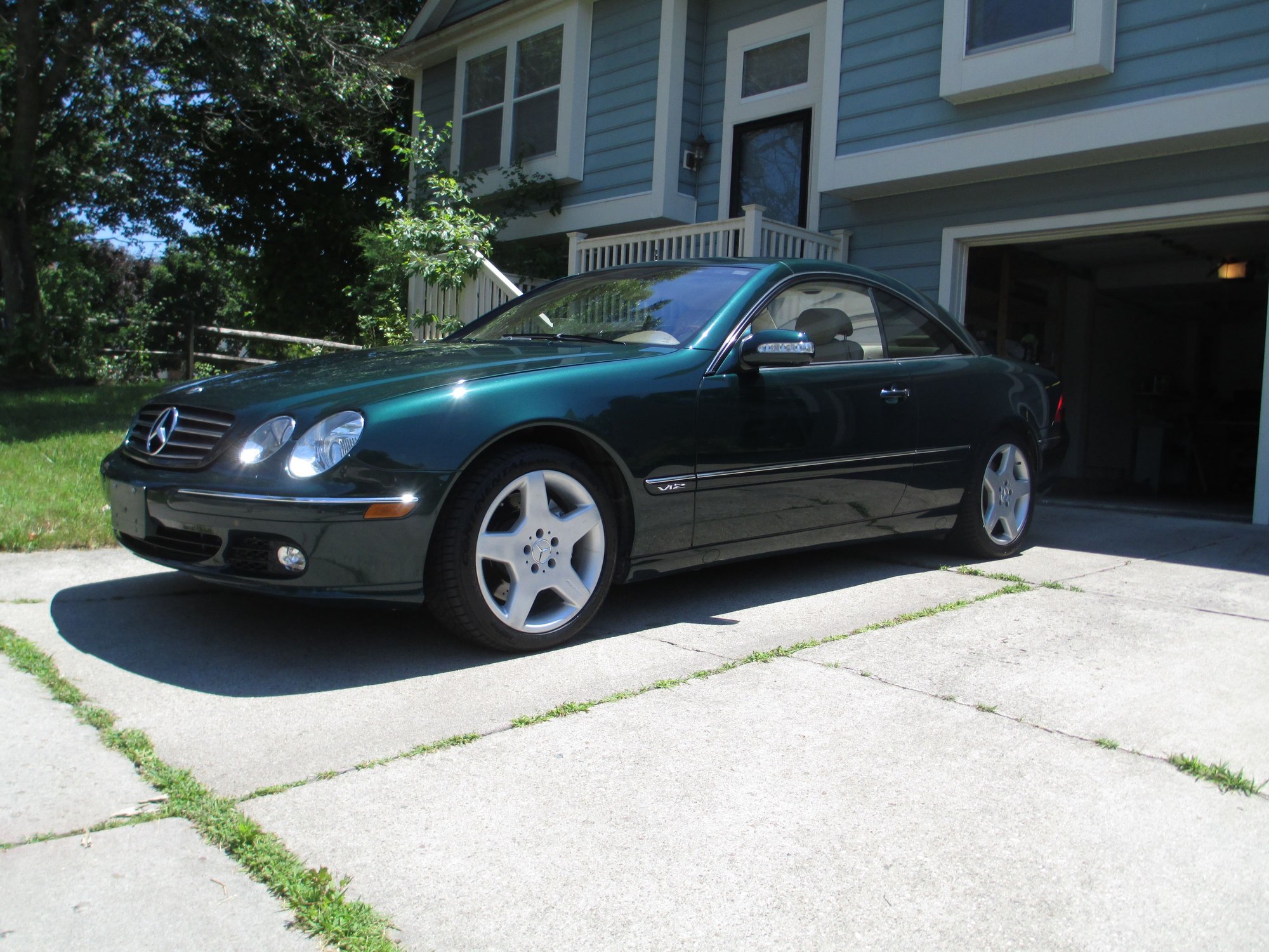

Here are my results:
This wasn't the worst one, the worst had gotten all 5 spokes chewed up, similar to yours. I did all 4.
They turned out quite well, but spend the time to make sure you sand the body filler properly, the slightest edge or bump will show.
