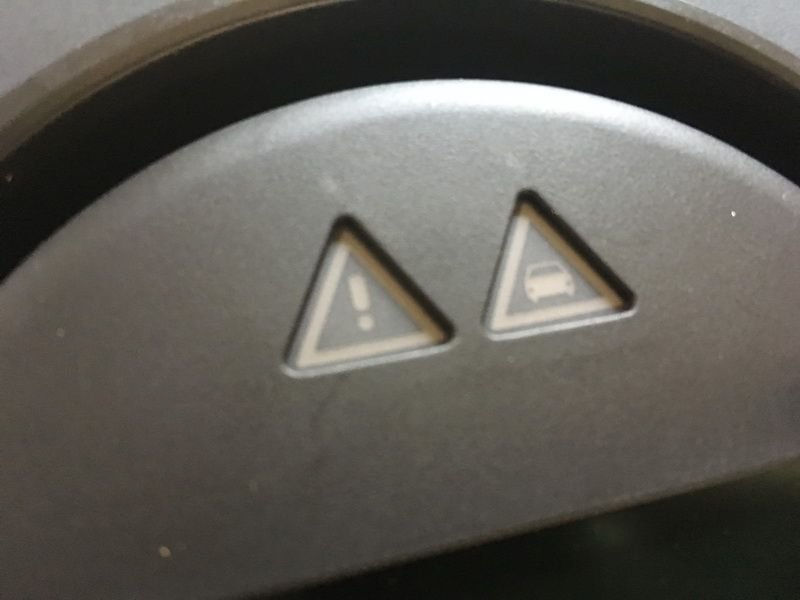

For those who drive a lot without ESP
here is the manual to dim the BIG ORANGE cluster triangle

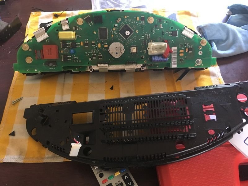

first I programmed a led swap but better keep your hands out of it as very compact
you need a cluster removal tool from ebay (2$)

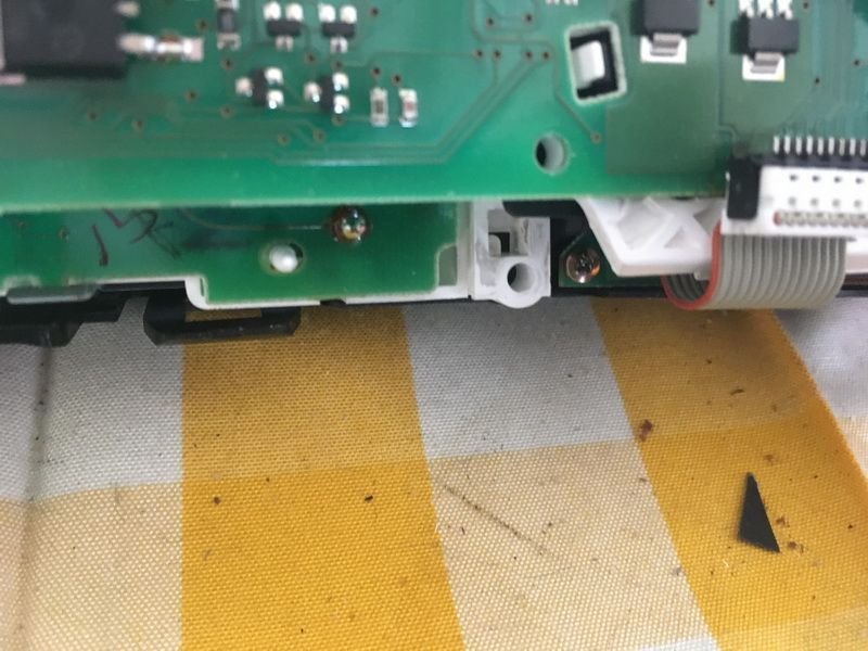

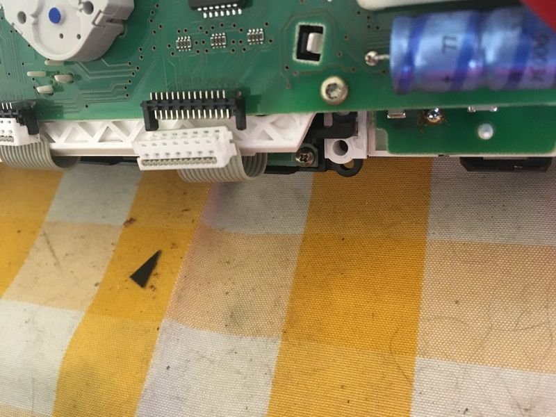

easy to understand, once you remove the back screws and removed the back, remove the two lower screws like on the two pictures
DO NOT unplug ANY connectors, I did that for another purpose
also, the triagle I am showing is not centered, that was the test one
make the hole in the center and you are fine always
