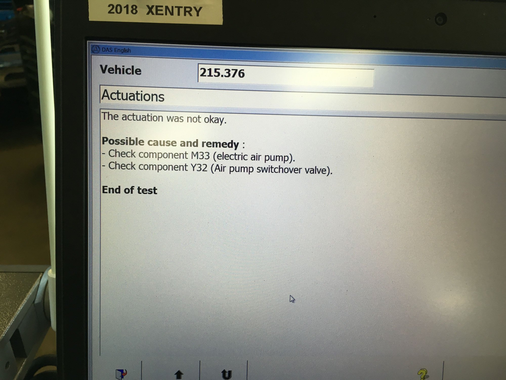

On the CL600; The Electric Pump is fine, but does occasionally turn on/off. The O2 sensor might have gotten a bit of oil on it, I got weird readings running the actuations.
What’s the air pump switchover valve, and how do I check it?

Here’s the valve:
https://www.mboemparts.com/oem-parts...lve-0025407097
I also ordered 4 Bosch 15733 universal O2 sensors ($20 each from amazon warehouse - if they’re bad I’ll return them).
I also read about clearing some choked up **** in the front of the engine, but I’m not sure what that is.
Hopefully this will nuke the code. O2 sensors should get done regardless - it *will* make a difference.
