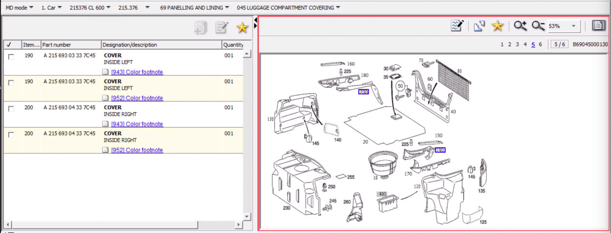

I found the culprit, it's the rubber gasket around the trunk trim:
I believe the EPC Document/Diagram is:
B69045000130
Looking now, I believe the Part #'s are:
Left: 215 693 03 33 7C45
Right: 215 693 04 33 7C45
Those part #'s are for one of the parts needed, additionally 170 and 80 would be good.
The trunk has to be removed to do this... thus I don't think it's worth it. An RTV solution might be the best option.

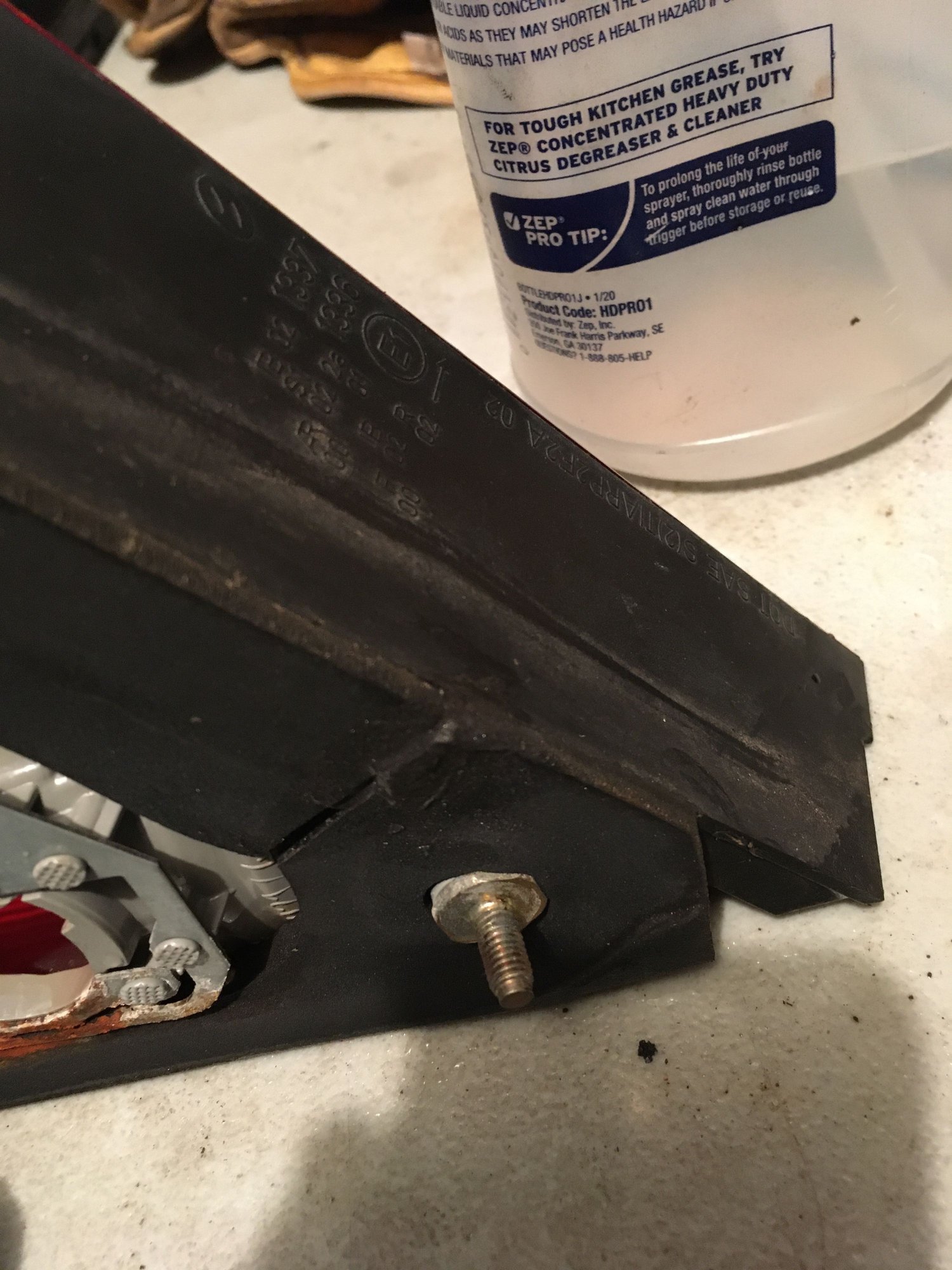

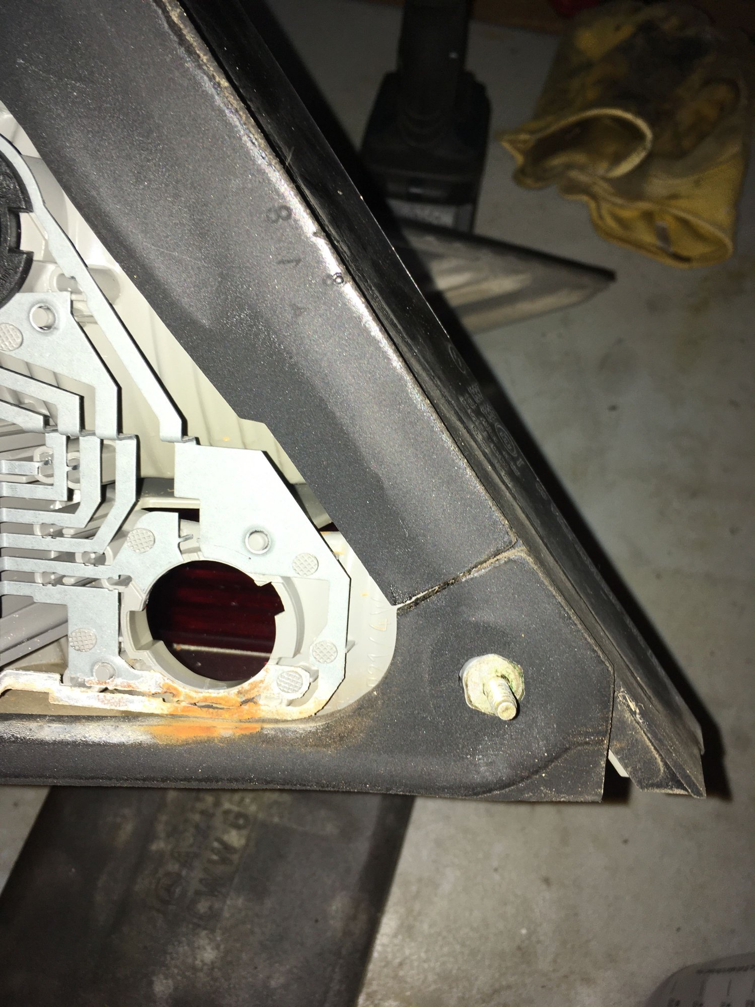

Found the issue, legit factory flaw from Mercedes. The gasket for the tail liglht goes around but doesn't completely close:
Guess where the water got in? Stupid.

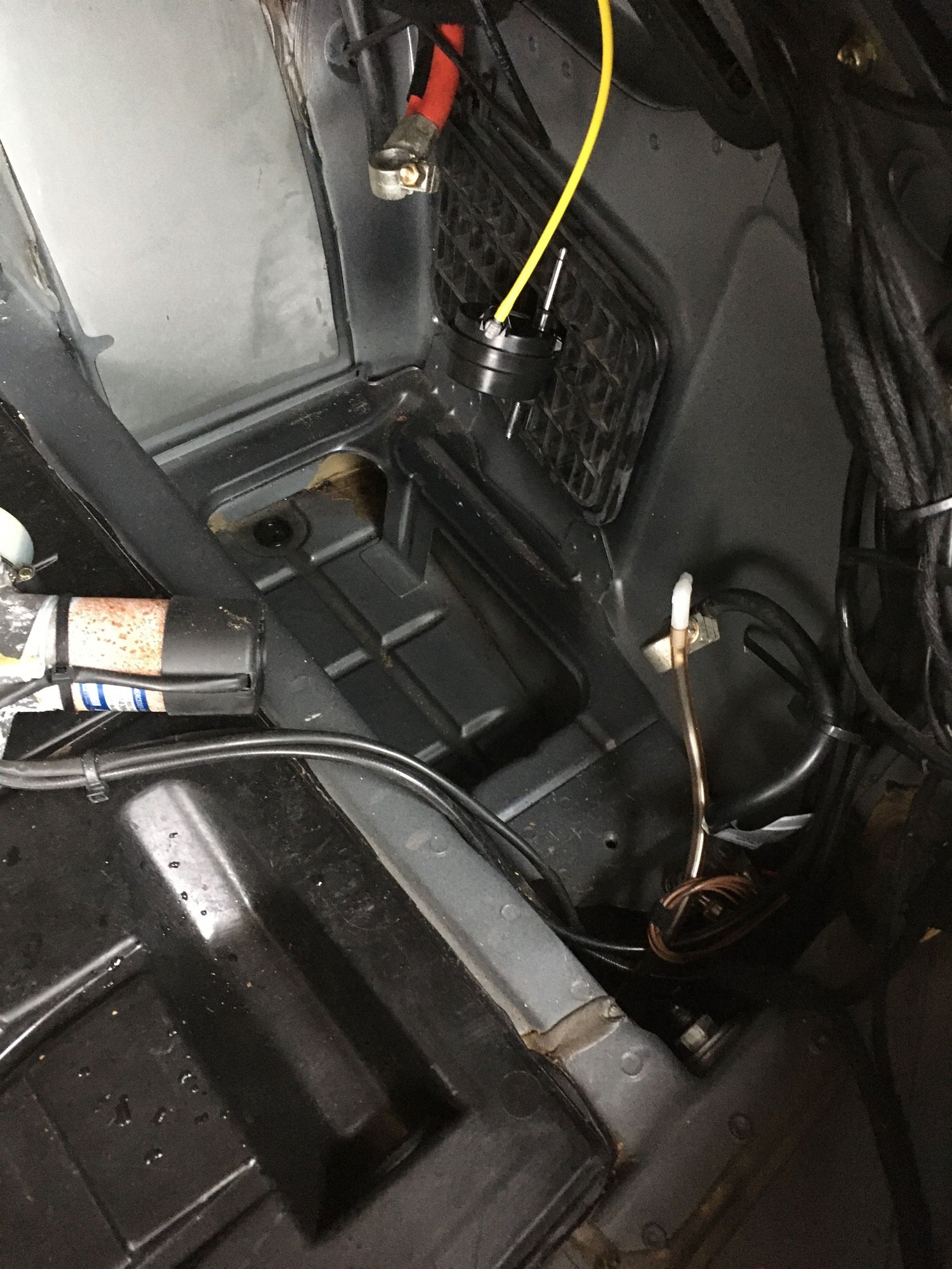

This water then crawled down into the area underneath the battery and made my trunk pump all rusted and ****ty (still working though):

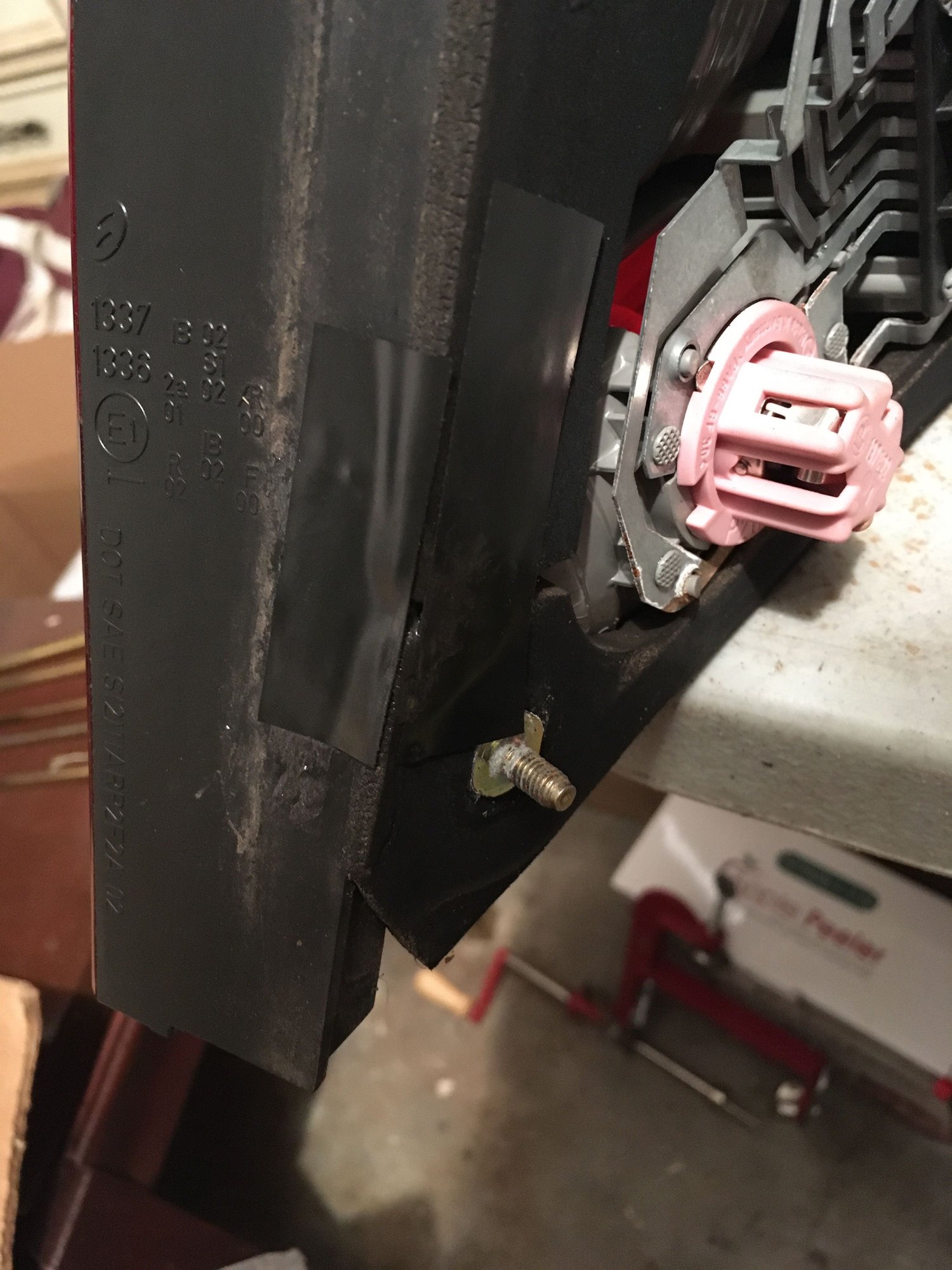

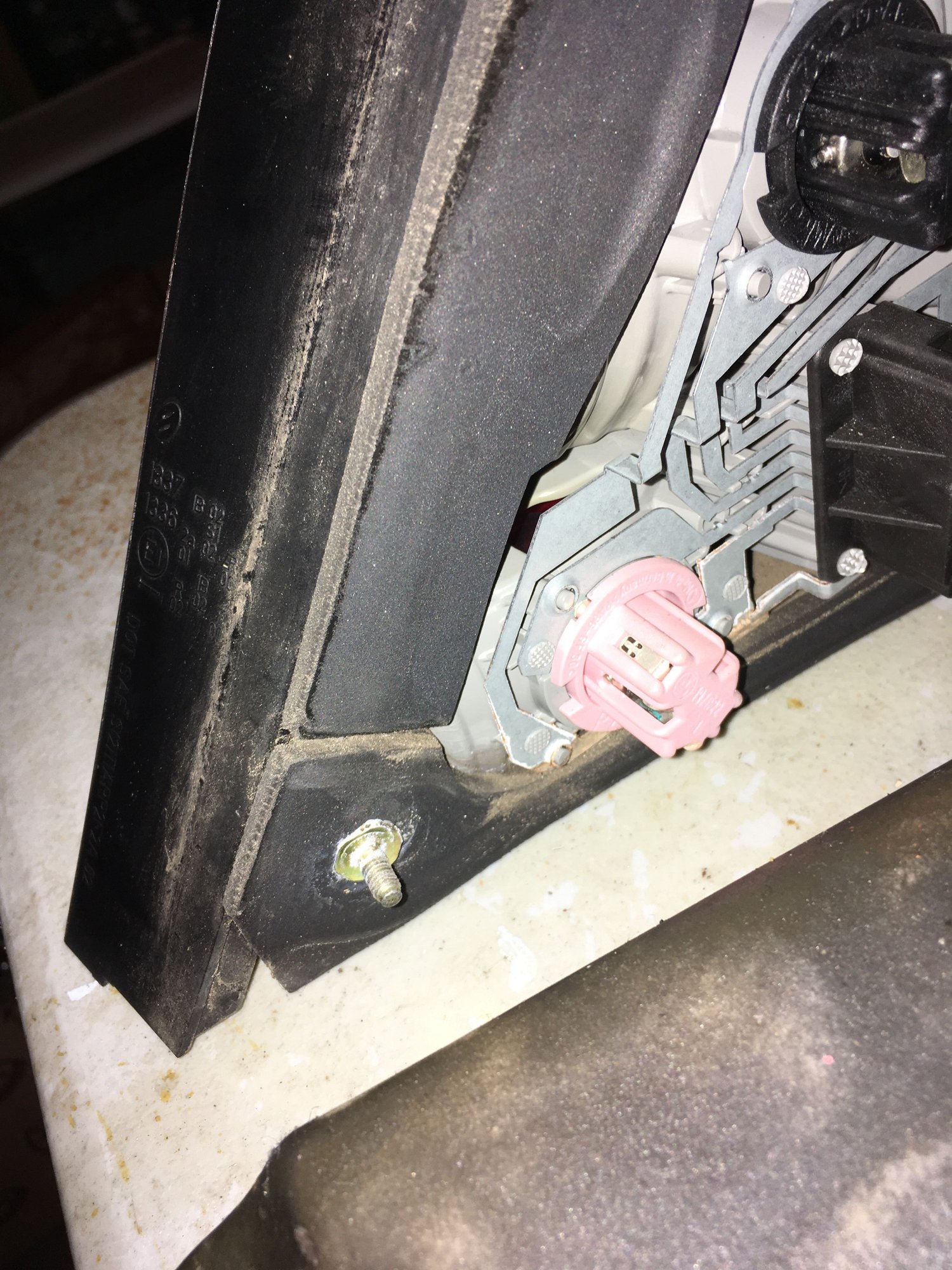

My solution involves RTV and electrical tape:
In addition I cleaned the seals from the prior post with rubbing alcohol and ran a nice line of electrical tape across those (along with some RTV where it detached). Hopefully this will prevent the water from even going in, and what little does go in will hopefully be kept out by the RTV'ed and siliconed tailight gaskets.

I just bought a pair of those for my cl65, and they're glued together at that seam... It's possible 20 years of weather caused the foam to shrink and pull apart at that joint.
