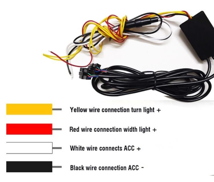

Hi guys. I’m new to the forum. I am in a little pickle here. Bought some led ldr lights and they come with some wires of different colours. I just need to know what colours means what light in my cl500 year 2004 model. When I look at the light harness I see different colours. Please advise. Photos are welcome too. Thanks in advance fellow MB enthusiasts
This is the wire bunch from the lights. And I need to know where to tap them

most easy is to remove the rear lights
take a ohm meter
find the ground connect ACC- there on the corresponding output wire
then proceed the same with each positive
you might end up with errors in cluster if the device is not "obd error free" certified. the case with lots of chinese cheap kits
