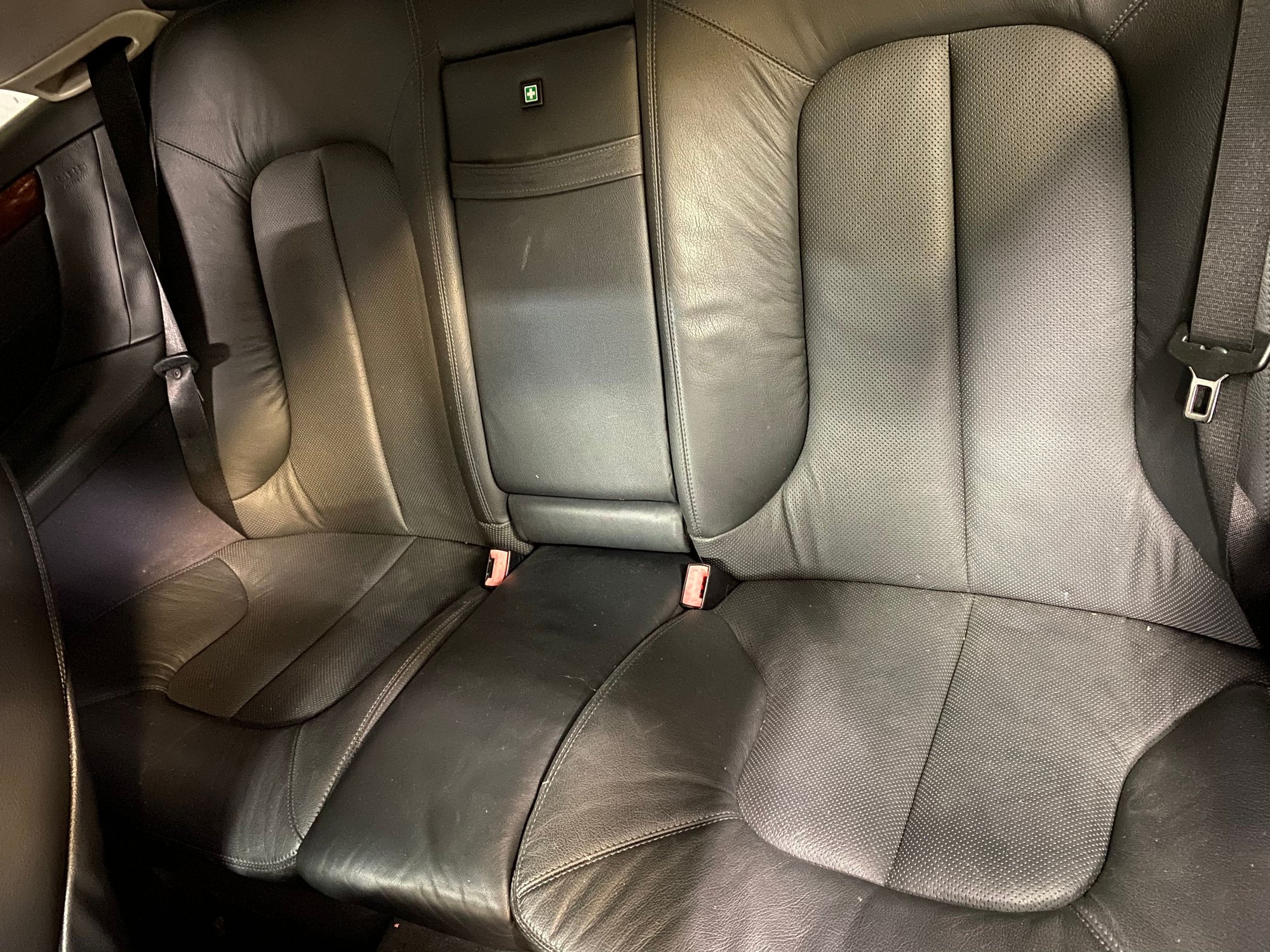

I had a suspicion that the rear middle seat from w220’s with reclining rear seats, would interchange with the w215 rear storage compartment and it looks like I was correct. I wasn’t 100% sure if it would fit so I just bought the quickest and easiest “black” example I could find, so the color match is not perfect but this is good news for anyone who ever had to lay larger items across the backseats, or wants to be able to fit 5 people in the car for short trips

Clever!
