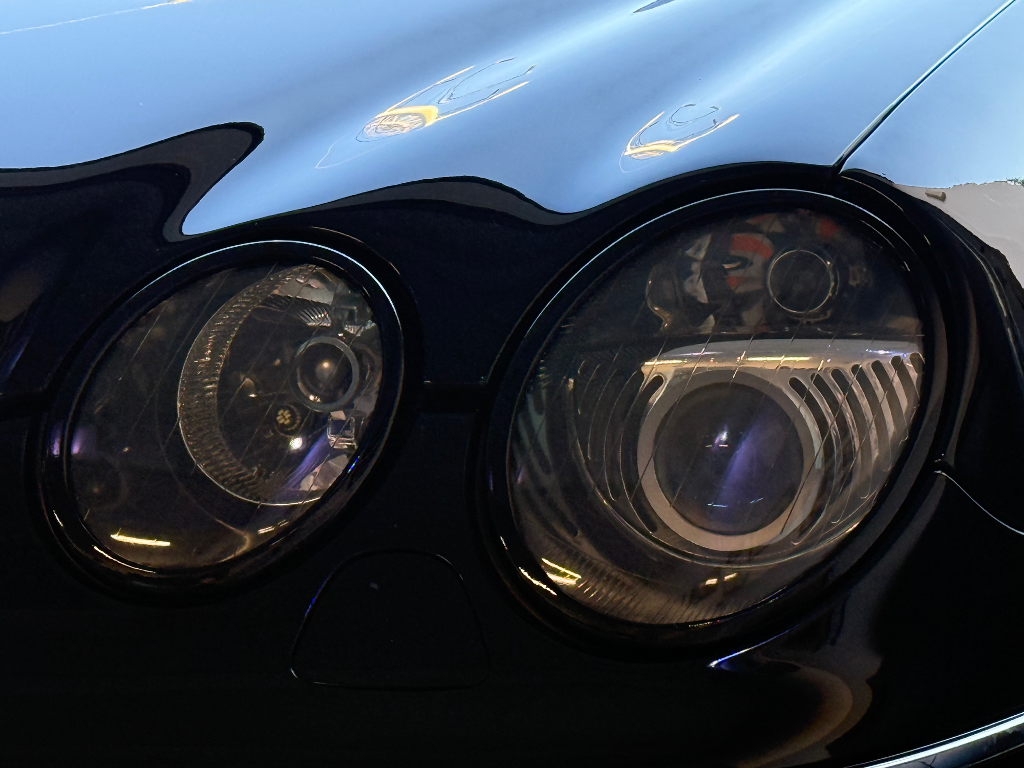

Next up on the list was fixing the headlights. I noticed output was bad and I suspected it wasn't the bulbs. I was correct. Ended up retrofitting new projectors and stepping away from the Bosch garbage. As a side note - the headlight wiring was obliterated. I suggest you take a close look at the headlight wiring before it possibly starts a fire.
Complete writeup and details here: https://absolutecarmods.com/?p=7322

Yeah, the interior headlight wiring on my CL55 was disintegrated as well... haven't really fixed it yet, so I went with wrappinng all the wires in electrical tape and planning on dealing with it later. I suggest getting a small square of XPEL or similar clear bra-like material and covering your 3rd brakelight with it... that entire assembly just seems spindly and liable to leak to me. If you do it well it's not very visible.

The third brake light was designed by an idiot for sure. I replaced the whole assembly at like 350$ which included the seal. They also make projector fogs for the 215 now which work great. eBay.

I'm just now coming back to this thread, but I noticed you don't have much info on your mounting plate for the LED unit on your site. Do you have a 3d file or item available somewhere? The light output on both my cars is middling at best, and I might as well fix them while Morimoto still makes this unit, lol.

PM me for details. I am not producing them at scale. I have been running the prototypes in my headlights for some time without issues. Also keep in mind that the process is fairly involved. It's not plug and play. The chrome piece needs to be trimmed extensively for this to work.
