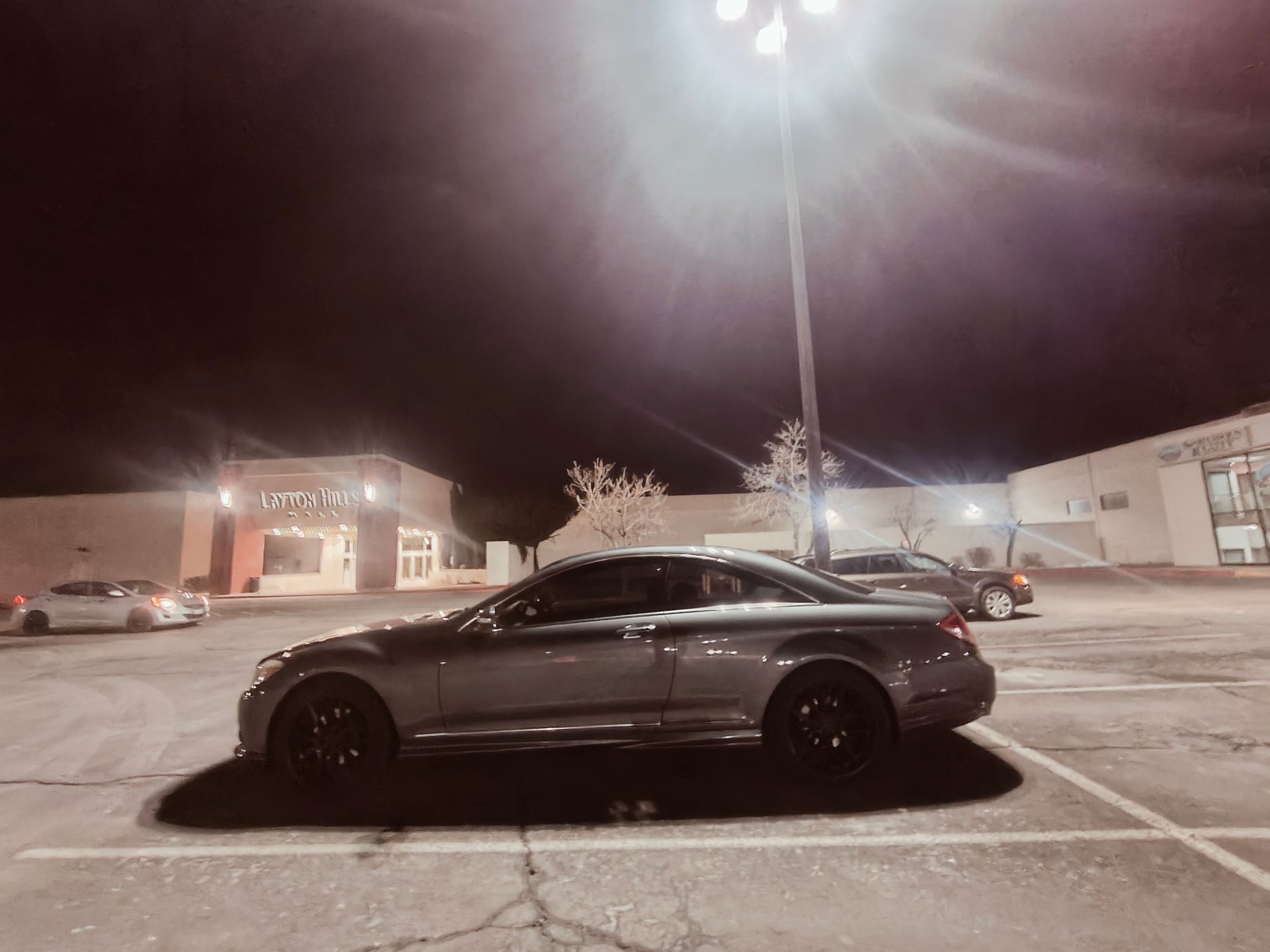

The last time I was able to drive her...
