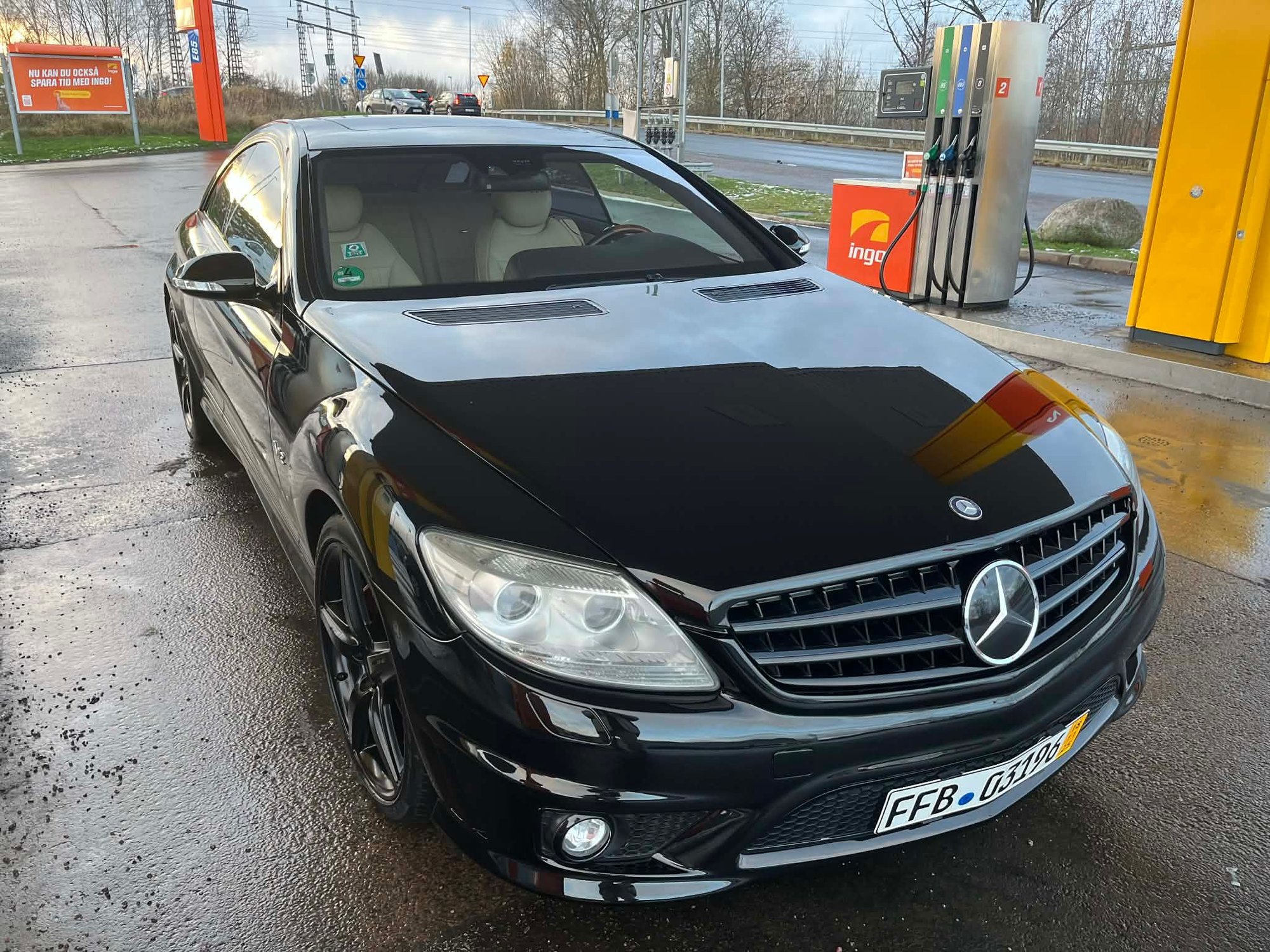

Hi. Last week I bought a CL600 from 2008 in Germany and drove it home (to Sweden).
On my way home I spent a night at a hotel, about half way home.
The next morning the car was of course cold, and made TERRIBLE gear changes to second & third gear!!!
The guy had me fooled of course, by showing the car all warmed up!
My mechanic says that the car does rev quite high before it moves, even when warmed up (like a manual car with clutch all worned out).
So I now have three choices;
- Flush the gearbox for about 500 dollars.
or
- Buy a used gearbox at eBay, för about 1.000 dollars.
or
- Renovate my gearbox for about 2.000 dollars.
What would you guys choose..?
And do you have any experience on this matter perhaps..?
Oh, and btw the purchase was made from a private person, so no use in even call him about this. It's an obvious con.
Thankful for your thoughts!
Best regards
Roger
