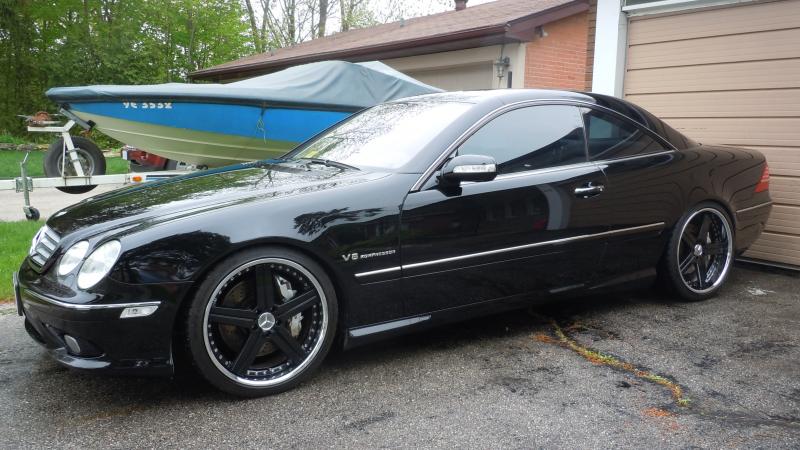

No "real" wheels for CL55 will cost $1500 (or less). That does not include the tires. Remember CL55 is a heavy car and a load rating 97 and up should be considered (some goes with 95Y but side wall is too weak for low profile tires).
Anyway, I am in no mean disrespect but it sounds like you are on a budget. You should probably stay with the OEM (they are very nice wheels).
Going with bigger wheels also means that you will have to lower your car at some point (it is not a must but your car will look like a truck with bigger wheels if not lowered). Lower car means much faster tires wear (unless you get the proper camber kits) ... etc. ... you see where I am going? Next thing you know, your $1500 will turn into more than double easily.
Note that if you don't have warranty for this car, you should save that $1500 for repairs should it come up.
Having said that, I am willing to go homeless to treat the car nicely so I understand how you feel.
Welcome to MBW. Any pics of your car?
Here is a black wheels with chrome lips

SLCL, those are NICE!!! My CL is black too and that's exactly what i was lookin for. What kind and how much are those wheels if you don't mind asking?

Mandrus Stuttgart ... around $3K a set (not including tires).
Watch out for used good brand name wheels in the sale section. You can get a nice set of DPE and/or HRE (wheels only) for around $2500 or less there. Good luck.
