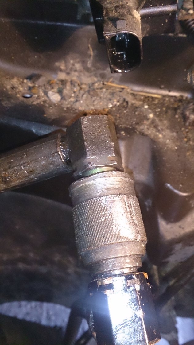

Can anyone help I'm stuck just replaying my front shocks and i'm stuck with this quick release collars ( yah right ) how do i remove the devil....

pull the ring portion of the connector (towards the connecting line) it will only move in one direction once it's engaged .
Reply 0
Jul 9, 2014 | 05:45 PM
Did you open up the bleeder valve? That should help.
